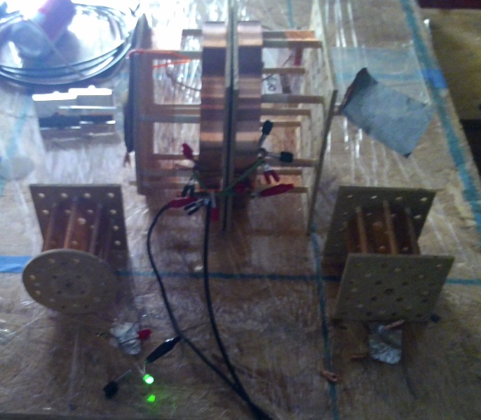

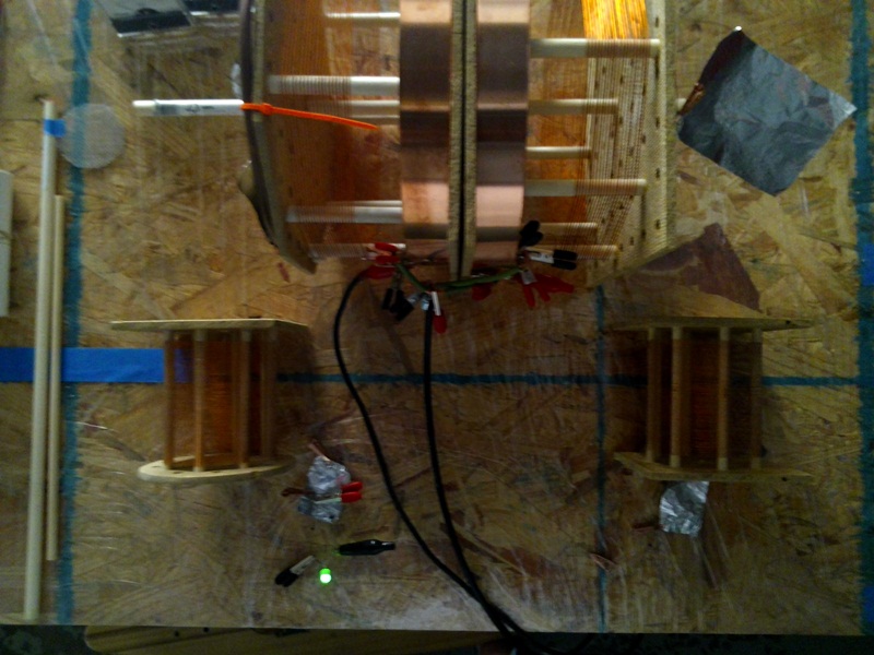

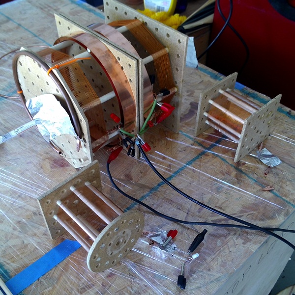

              • Using these:
                F = 3670000 cycles/sec
                Secondary
                Height = 4.08cm
                Diameter = 20.7cm
                Number of turns = 20
                Wire = 13 +/- metres 26 SWG (thin wire issues resulting in slight octagon shape therefore reduced length, estimated actual length = approx 12.92 metres)
                Approx 18.9 grams of copper in coil
                Extra coil
                Height = 8.28cm
                Diameter = 8.28cm
                Number of turns = 126
                Wire = 32.27 metres 26 SWG (advisable not to use thicker wire otherwise no room on coil frame, impossible to space 126 turns evenly as is)
                Margin of error between calculated and measured frame dimensions after construction = <0.5mm
                Primary
                2 turns, not flat spiral
                Wire = 2 x 20 SWG + 24 SWG parallel wound
                Tests results = Forthcoming
                • Don't have the necessary size of copper for the primary on the AM RF range. instead went with a 4Mhz fq and built a CW/CCW pair. started with the basic equations Eric posted and 'adjusted' some details to factor in the HF. I'll be putting together a document and mailing it off to Eric, it may be of use to him or not.
                  I'm going to be moving onto another area of research in the same vein but from a different approach. electrostatic plasma optics. It's been a very worthwhile to detour here as it has helped with my own research on the dielectric.
                  couple pics hopefully should load. 4v 30 milliamp LED lights brightly near the designed frequency, loads more tuning needed but all in all it was faster than i anticipated in getting it to work. the CCW extra tuned quickly while the CW has been difficult, very strange.
                  no ground to earth, all chassis ground to the OSB that has a aluminum foil backing and wrapped in 3mil plastic. the foil back is the shared capacitive ground to the coils.

                            The Inductance calculations are mine.
                            Reference to 'second harmonic' is ??.
                            For those of you who are familiar with my Maths at 'Crystal Radio Magic' will see that Tesla's operating frequency is 96 Khz and you can go either up to 148.7 Khz or down to 60.27 Khz where Tesla was operating.
                            Will repeat that Eric's calculation for the Extra Coil did not work but my accidental did and am now building a repeat of the first coil and adding some extra turns in an attempt to tune to a peak.
                            Nobody seems to have woken to the fact that Tesla's Secondary and Extra Coil WERE OF THE SAME LENGTH but of different diameter!
                            Look at the calculations above and you will see that they are nearly the same at 800 meters.
                            This is where my first Extra worked by having the same length as the Secondary.
                            Note also that the Inductance for the Extra Coil is 2x Secondary.
                            Will be winding the Extra tomorrow so will come back with information when completed.
                            Also of note is the final Secondary number of turns was 17 and have a tap at that point for experiment.
                            Have always wanted to build an integrated Condenser and Inductor and that is also what Eric is now proposing but difficult to do when you have two turns of Primary but have worked out a compromise that fully integrates both and will advise when that is completed.
                            My Primary did not work with a loosely coupled Condenser and can see the reason for integrating both.
                            I would like to repeat that my first Extra Coil worked by having the same length as the Secondary and the same 14 awg wire.
                            Distance of pickup by the 1N34 probe head to the high impedance Headphones from the radiating Extra Coil was about 8" through space and considered to be a Telluric signal.
                            Have an Oscilloscope set up for measuring both the Hertzian and Telluric component and will advise when that is done.
                            Later and hope this helps.
