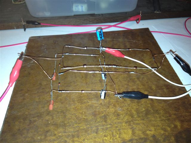

                          A circuit with FWBR and a 220uF,25V cap gave me low Voltage and High Amps, so i combined a Jess circuit with this, now my Amp reading have gone up from 100u to 5mA for one circuit, and the Voltage a little up.
                          Secondly the diodes do make a difference, I built 2 of these one with 1N4007 and one with 1N60P germanium diodes, nearly 50% improvement with the Germanium Diodes.
                          The result of the above is I can now have a LED lit up nearly 24/7 (4.5V,30m
