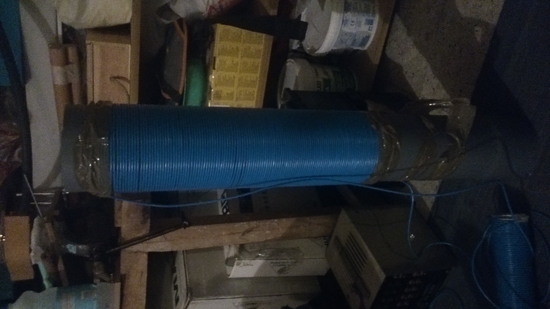

                                Antenna is a long wire, 35/40 meters including coil, 1.5 mm in diameter, down from the roof to the garage and the coil is located about 7 meters before the connection to the circuit. The earth is a copper rod about 2.5 cm in diameter and 2.5 m long stuck in the ground, in the garden.
                                You can find attached a photo of the coil
