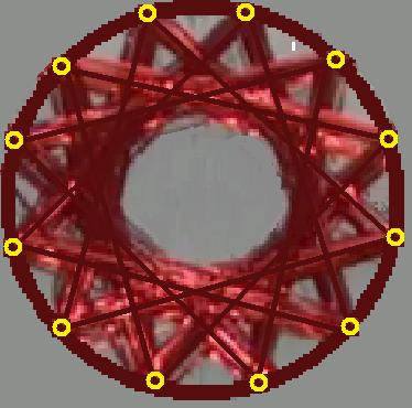

              As for the starship coil...if you look at this video by hhoforvolts and freeze it at 1:42 you will see the gap formed between the golf tee and the main circle of the coil. All the wire in the star point...is useless to the field and wasted.
              Cut a small triangle piece to fit in that gap and up against the main coil. That is your new winding jig instead of the golf tees. Would be nice if the outer side of the jig was rounded to the proper arc but wouldn't be necessary. Fit finished coil into pvc and pot it if desired.
              Another problem to be solved: I think skycollection uses larger wire. It might be better for lower resistance and to utilize the current capacity of the mosfets with lower voltage. I don't know motors that well. Smaller wire more turns or larger wire less turns but more current. Which is better....I have no clue.
                  Close to this? Starship with tips removed (bypassed). Not the best editing job but I think it's what you are talking about. Same number of tees (12) represented by yellow circles. Golf tees or similar move inward and shift direction around the circle.

                  • #99
                    yes, basically...but you can move that outer circle almost completely in to the inner coil if you use different pegs like this: the smaller the better as long as it maintains the inner coil shape which can also encompass a hollow or pvc core so other cores can be inserted if desired. Ferrite cores would probably give you a boost at the frequency you are using...maybe even silicon steel would boost it...not sure...not an expert on coils by any means...the rodin stuff attracts me to learn more though, especially the starship.
                    starship by OrionLightShip, on Flickr
                    The peg that creates the star is not used....star point added for reference only. the new winding jig is rounded and close in to the working coil, saving wire and creating something more easily packaged.
