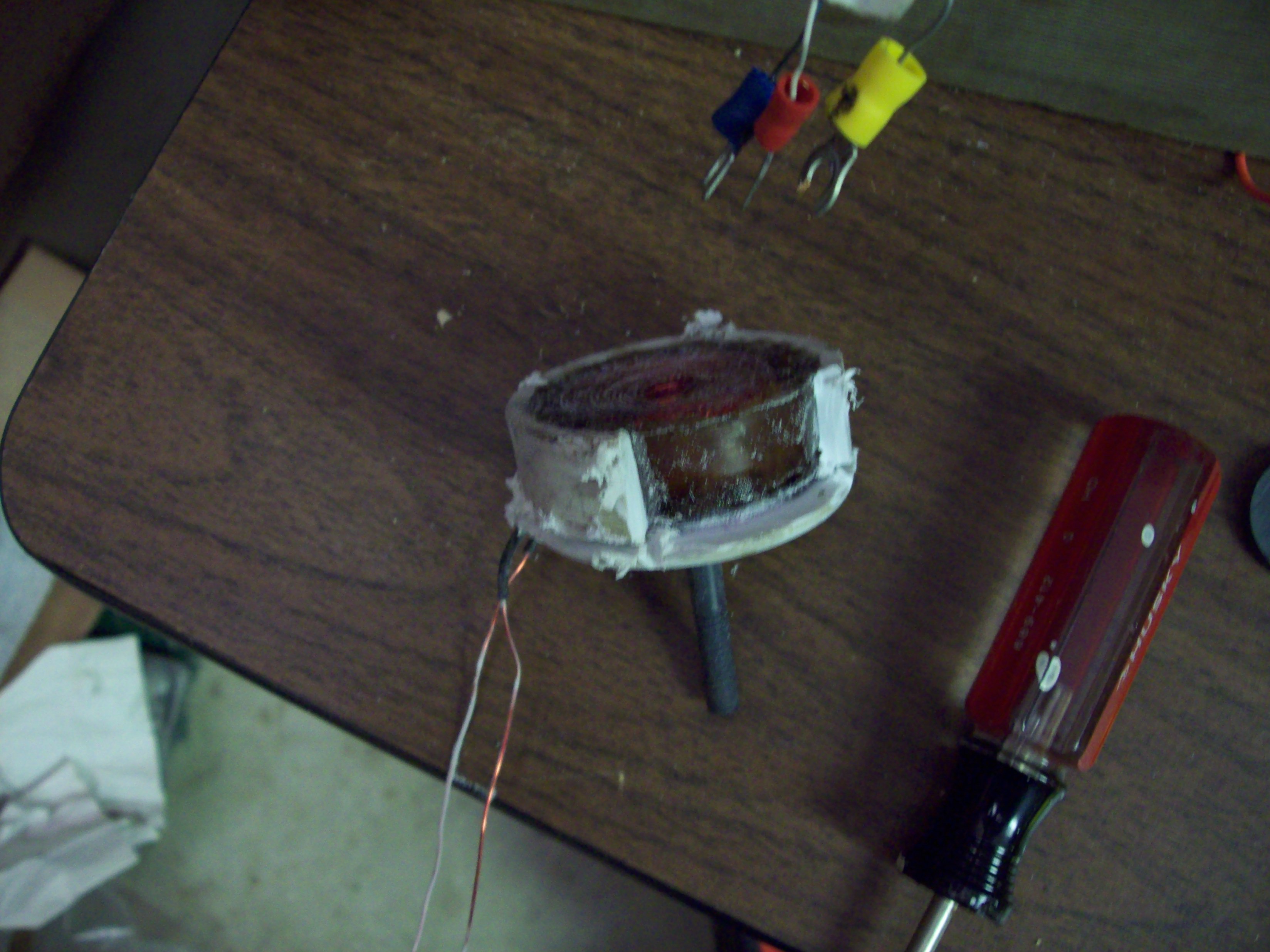

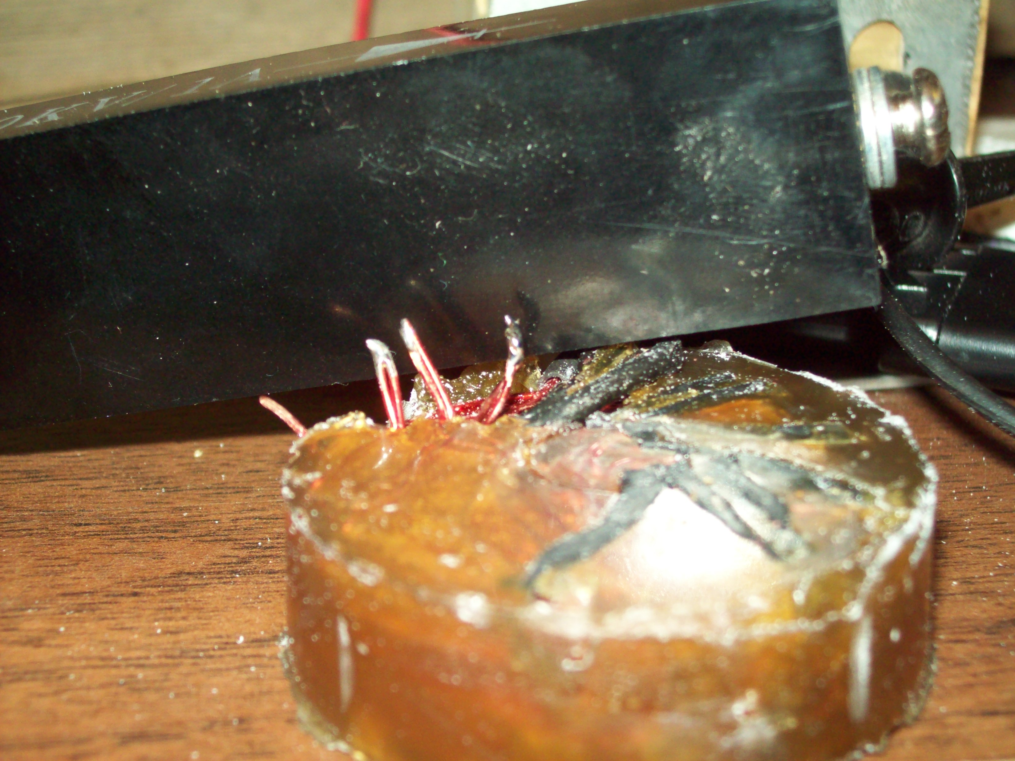

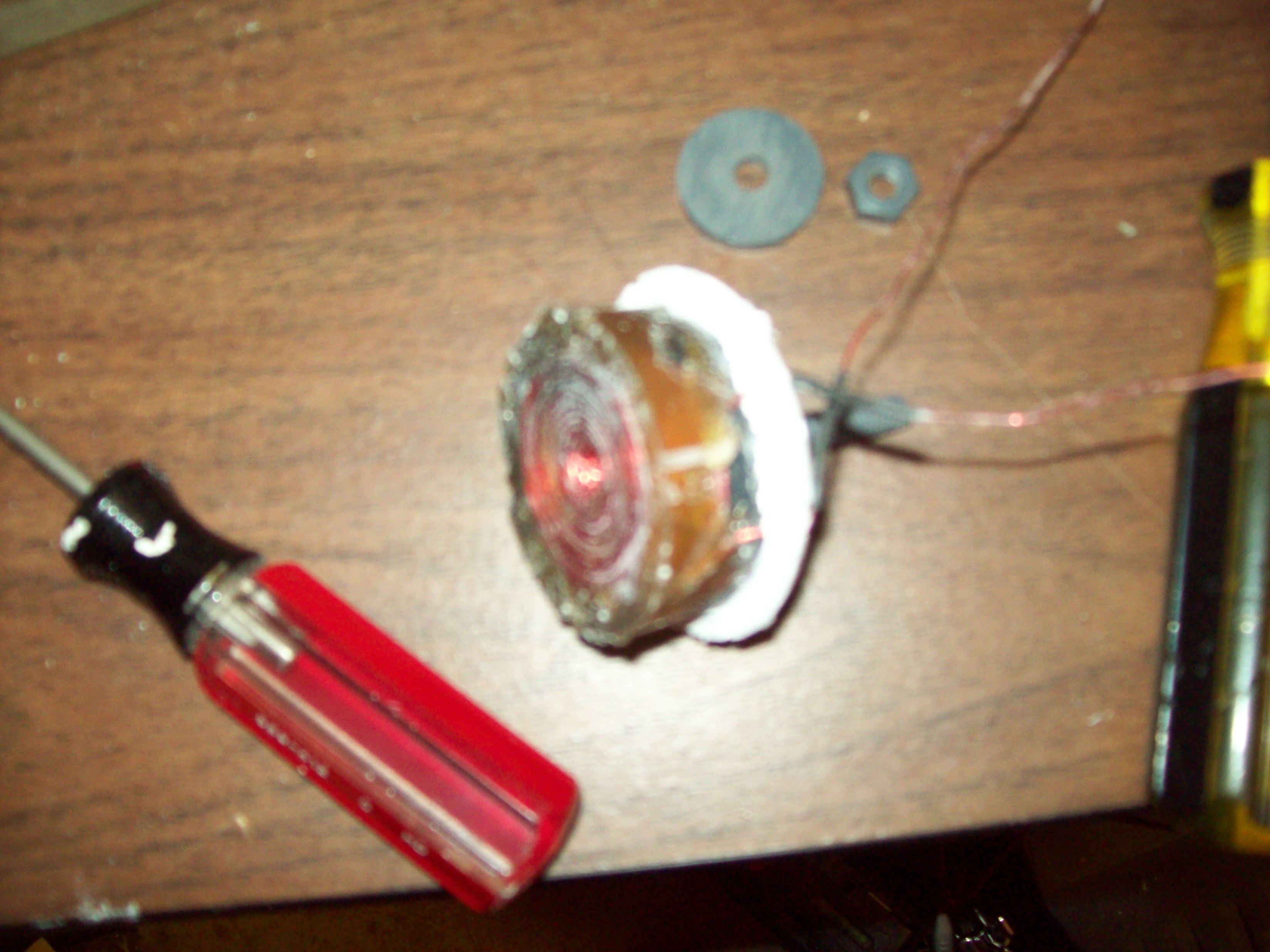

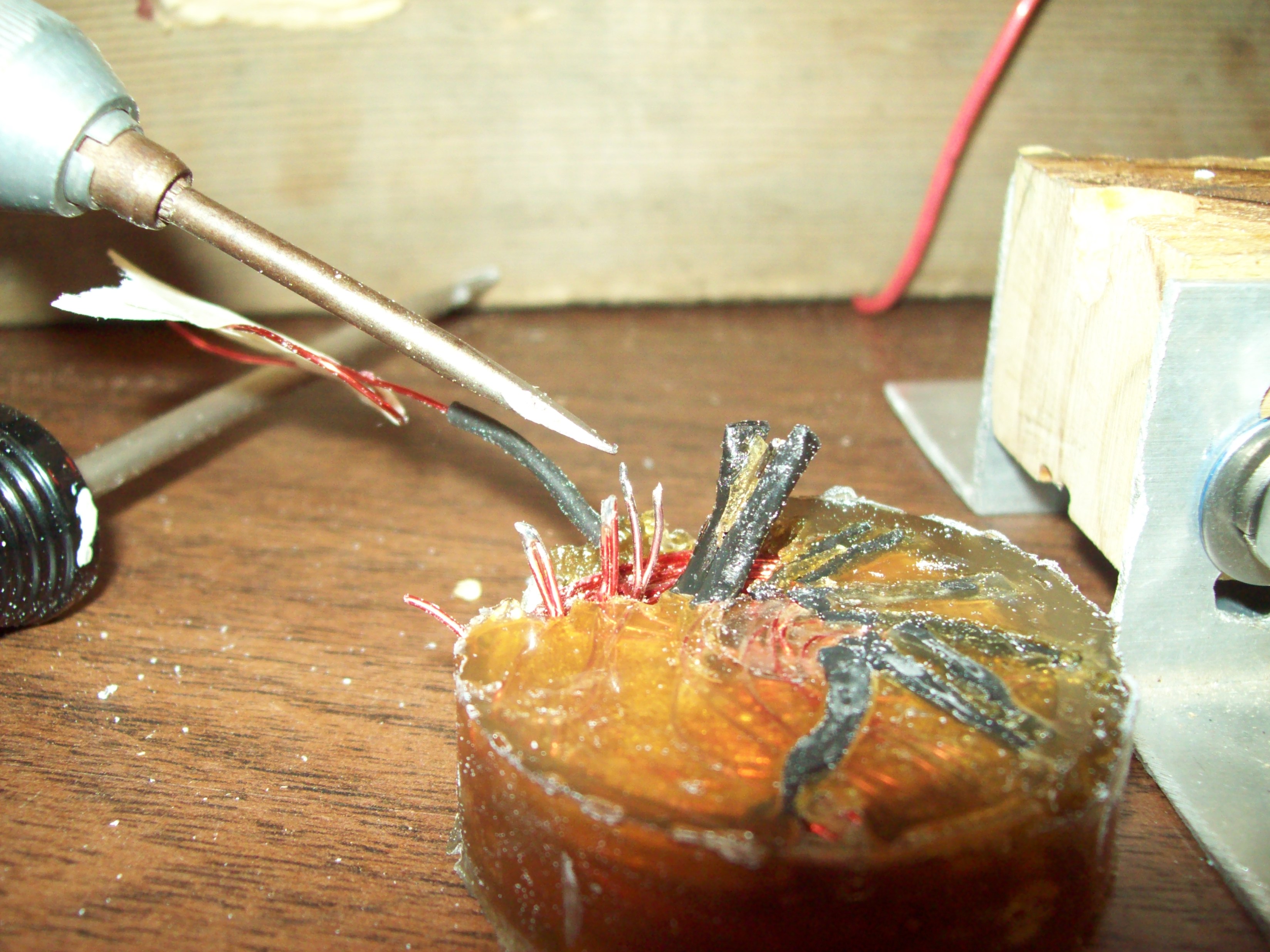

                        Coil on the mend
                        Found the broken solder connection. Will re-solder all connections then re-glue. Down for a couple of days.
                        Coil during disassembly.
                        Almost apart.
                        Broken connection.
                        Re-soldered connection.
