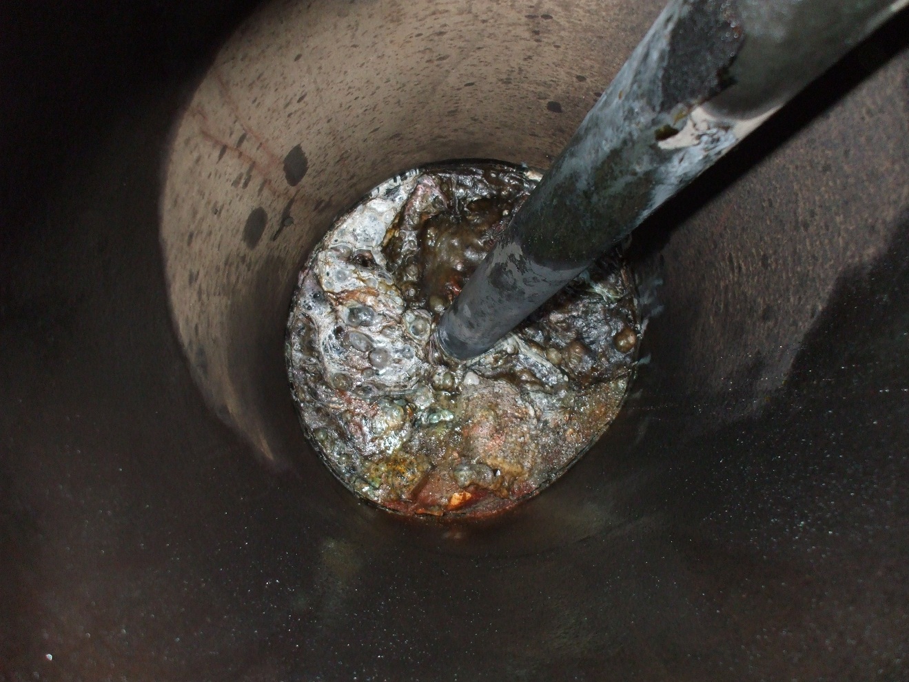

Has anyone tried running bubbles up through the condensing vessel? I am interested to know what kind of extra pressure it creates.
