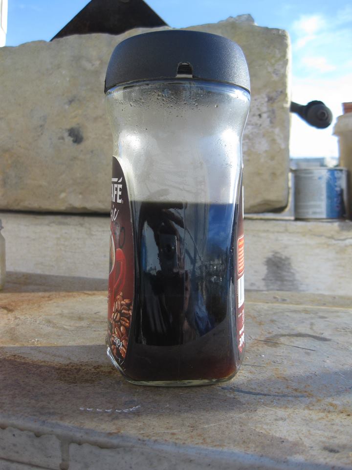

                    • pyrolysis oil
                      l try my pyrolysis again l have trouble with burner sometimes nozzle block. after 45 minutes of heating bubbles stops but begun the first drops after 15 minutes l find little fuel. l dont know the tempreture. l use waste oil about 30 litres.why bubbles stop and the fuel begun coming out? it is normal? l dont have catalyst.just empty reflux.fuel burn easy maybe diesel and petrol

                              • Originally posted by jonathan View Post
                                thanks excalibur maybe tempreture proplem i will check my tempretures next time.are this probs good?.l meant i dont want to use blind hole.thanks
                                RTD PT100-K Temperature Sensor 2m Cable Stainless Probe 100mm 2 Wires T5 | eBay
                                An RTD is not the sensor to use for the range that pyrolysis occurs. It is better to use a type K TC (thermocouple).
                                Thanks for the photos, they help diagnose your problems. It sounds to me like all is good, but cracking is marginal. Do you know your retort temperature? Thermal cracking occurs at 400c.
                                Are you using a catalyst? If not then if you add one, then you will get better results. If you can not buy zeolite, then just add a cup of ash to every 4L of liquid to be cracked.
