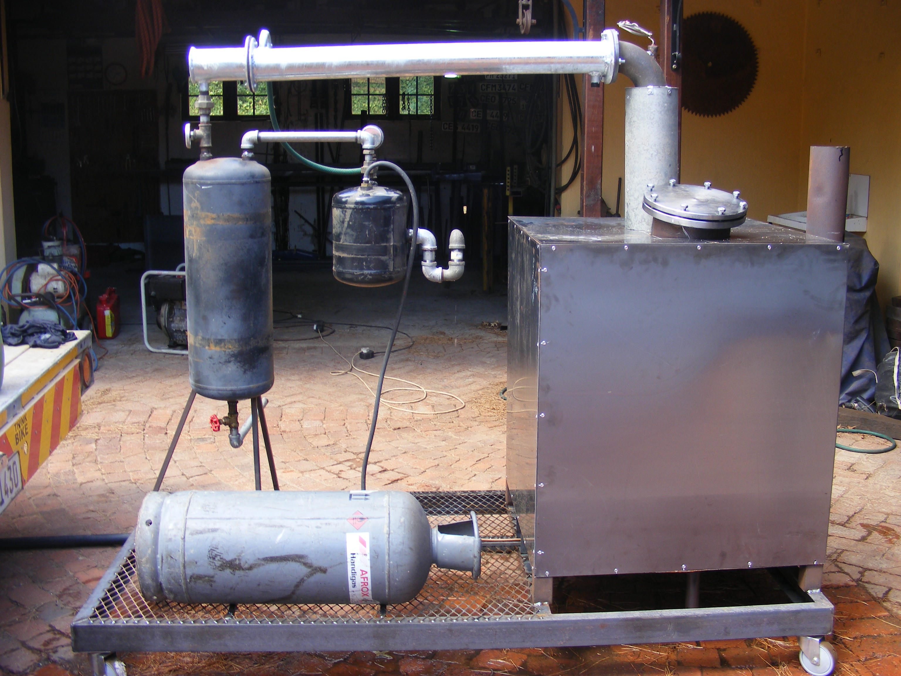

With my last run, I used either diesel or non-condensable gases, but not both at the same time. When running on diesel, I temporaily store the gases in a gasjar. Flame-outs can be and were a problem with earlier iterations but the turk burner head has some steel plates inside which glow red hot. Indeed the turk housing and feedpipe often are red hot too. This red hot steel creates a natural ignition for the gas and I had the gas burning for a couple of hours continuous. The diesel reservoir target was 120*C , downstream a gasoline trap followed by a (unheated) bubbler. It was a good amount of usable gas however I discovered that I 'cracked the product too much' and the diesel was a bit light. So next run I'll be using a higher reflux temp so may not get the sheer volume amount of non-condensables. We'll have to wait and see...
Yes, if there is a flame-out, there can be a loud bang as the gas suddenly ignites. It is a bit "hair raising" and it did blow the forced draft fan off the inlet more than once. When the flame has to be reduced to curb retort temps, there is much more of a chance of flame-out.
Later mods, I thought I'd use a LPG gas appliance method of initial ignition. They use a thermocouple to sense the presence of flame plus a simple electronic spark ignitor. Look at gas fired water heaters, central heating units, etc.
