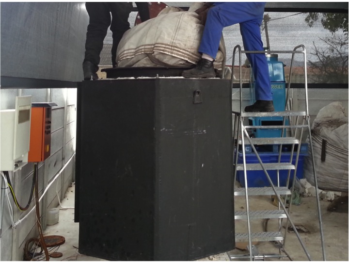

          Hi guys.
          Been reading the blog for the last year or so, slowly building my plant, almost done. I'm from South Africa. I studies polymer science up to a masters degree in the in the early 2000's.
          Added a view pics, will be running my first run in a week or so, will post results.
          Kind Regards
          • new project

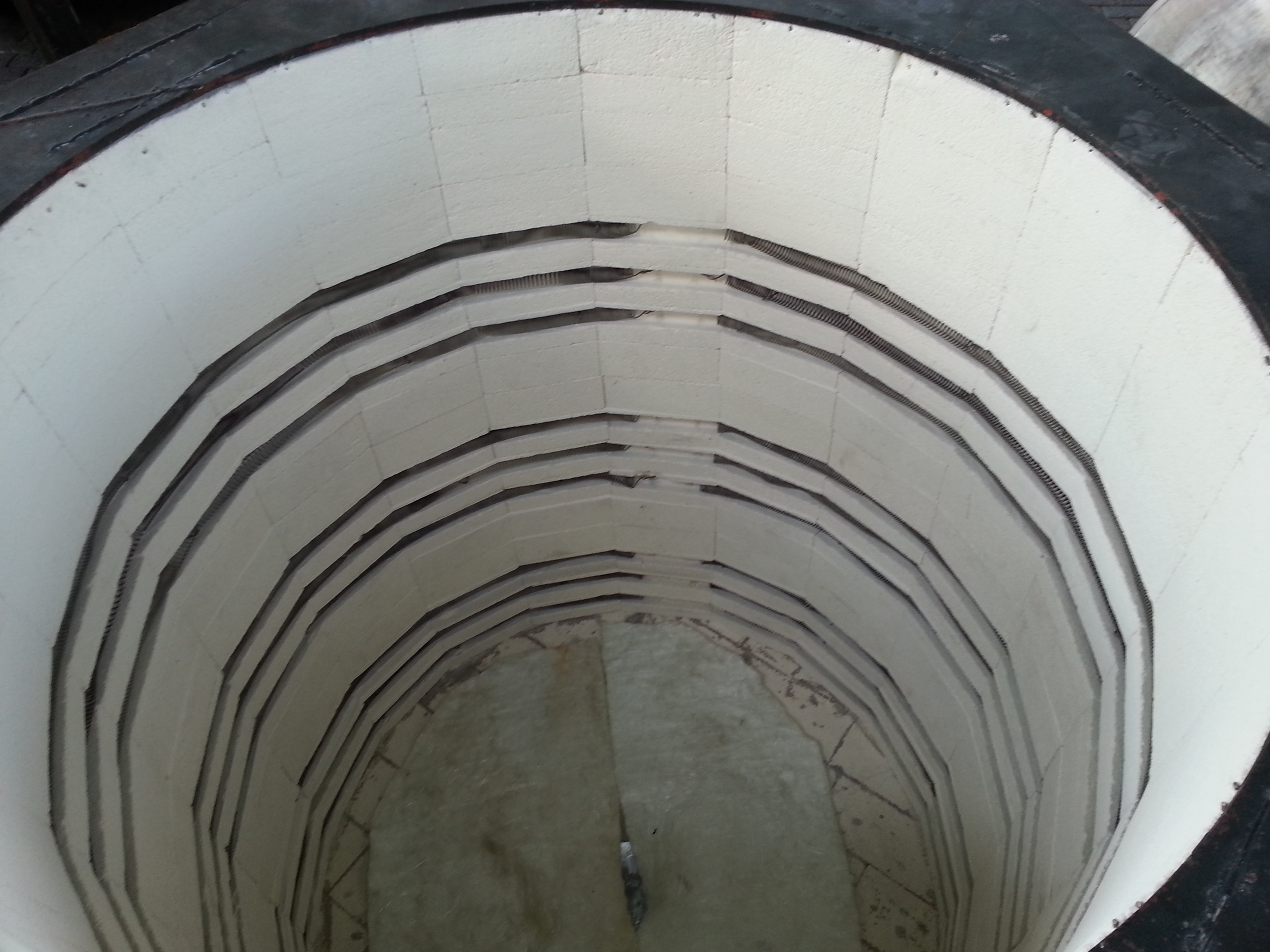

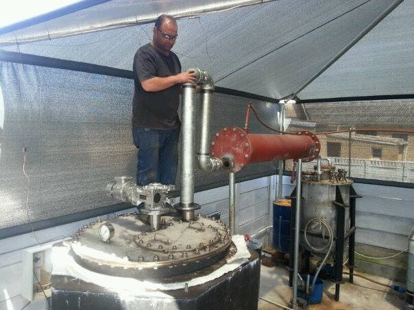

            I would like to give some figures and would like to know how it sounds
            Capacity of reactor is 900L, think I will get about 450kg of shredded mixed plastic mostly PE, or a mix of WMO and shredded plastic about 500kg
            Energy used to heat reactor is 3phase electricity, total capacity of oven is 45kw, but presently only using 30kw (only using bottom 6 0f the 9 X 5Kw elements to start)
            Dual condensers: primary is straight rods between reactor and storage tank/trap
            Secondary condensor is the top third part of storage tank consisting of internal looped and cooled pipes positioned between metal flakes suspended between two metal grids.
            Planning to make one combined fraction in the diesel range, depending on the specific density of the product I will insulate the reflux if needed.
            Catalyst will be a locally sourced zeolite mixed into the wet batch.
            AAS
            • new project
              Only S/Steel used, minimum thickness of 10mm used on the lid, mechanical seals everywhere, pressure gauge installed, will be running at 400degrees.
              Kind Regards

                  • Welcome AAS, looks like you have been busy, and made one of the best pyrolysis units posted here so far. The only recommendation I have is more uniform heating tends to increase heating rate which increases throughput. So, instead of turning off heating elements reduce the power going to each heating element by either wiring them in series or using several variacs, one for each heating wire, will allow you to reduce the watt density easily, so that you can spread those watts uniformly. Also, a hot plate at the bottom in the form of a coil of nichrome wire under your retort will spread those watts more uniformly while increasing the heating rate.

                      Thank you beyond biodiesel, I'm hoping the stirrer will somewhat compensate and at least distribute the heat uniformly internally. More contact exposure and from the bottom makes sense, will use that in next prototype, cost and simplicity of building made me opt for the existing arrangement of elements.
                      The furnace ways about 2 tons and reactor about 500kg's so now that it's in position, it's staying there for now.
                      AAS
                      • Welcome and very nice work!!
                        Wow, 30 -45kw!! How much can you get kw for? I looked at it when I first started and normal rates were 33c per kw.
                        Have you a schematic of the condensers? I'm always looking to learn, especially how to improve efficiency or recover heat.

                          Wow, look at you go! I recall someone mentioning galvalised material was not a good idea? The pipes going from the retort to the condenser look galvanised. Does anyone still see this as a problem? (tried the search function to find the notes but couldn't find any reference to galvanis(/z)ed)
                          What diameter is your reflux pipe? What a beast!

                                The first condenser is straight forward. straight copper pipes with water around it.
                                I will add a picture of a schematic of the second condenser. The first condenser reduces most of the heat, the second causes precipitation (like a car driving in mist) the small molecules hit the metal, then another molecule hits that molecule an perhaps now combined they can precipitate out in liquid form.
                                Using an small evaporative cooler to cool the water.
