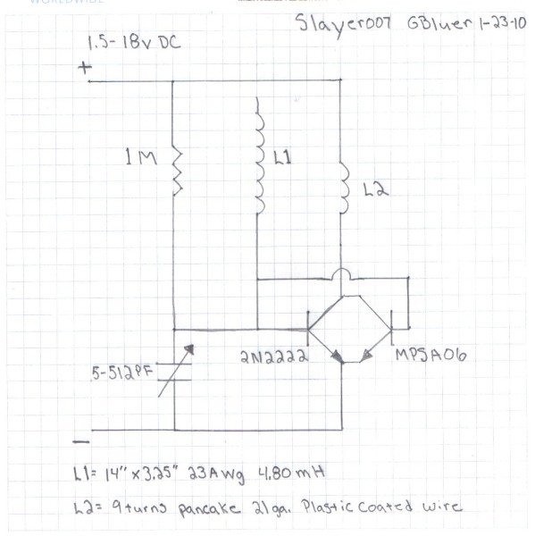

I'd recommend a capacitor discharge for the Slayer primary....Why not charge a cap to a determined voltage, and then dump it though the coil with a zener or a reverse biased transistor for an avalanche discharge? You only have a loose coupling between the primary and secondary, so you should hit that thing like a hammer, not continuously poke it.... The more often you dump a charge though it, the more you disturb and prematurely kill the ringdown resonance of the secondary(that is if you don't make the primary and secondary resonant with each other or drive the secondary at its resonance).... Maybe have it dump the cap through the primary and into the + of a battery for charging?
