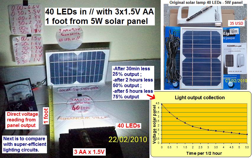

I found another way to evaluate the light output curve versus time.
I put the light in front of a solar panel and I measure the voltage output of the panel.
[img] [/img]
I ran 40 LEDs in // from 3 AA batteries (1.5V) in series.
After 30 minutes light output was 25% less, after 2 hours it has reduced by 50% and after 5 hours it was less 75% from the starting.
I will try the same setup when I'll get my replication of Slayer's Coil, running 40 LEDs in series, seeing the evolution of the brightness versus time, and how long it will work from 3 AA batteries.
[img] [/img]
