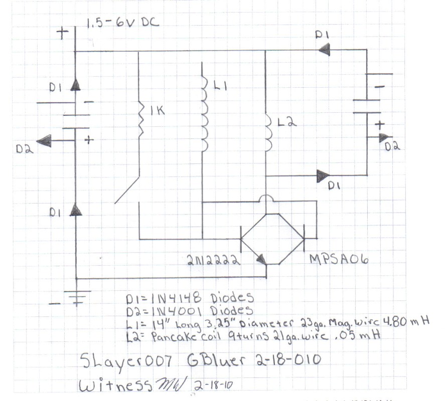

                    @slayer007,
                    thanks for your work and videos.
                    In the last circuit you published, which is the one here
                    posting #261
                    you drew the symbol for a ground connection on the minus side.
                    Do you really have the minus of the cell phone charger connected to ground or is the circuit "free floating"?

                      Marxist the Ground in the circuit it just the negative on the cell phone charger.
                      It's not an Earth Ground.

                      • Here is the circuit I used in my last video.
                        It will run with a 1.5v up to 6v with the coil configuration.
                        Next I'll try a 6" diameter coil and see if I get better results.
