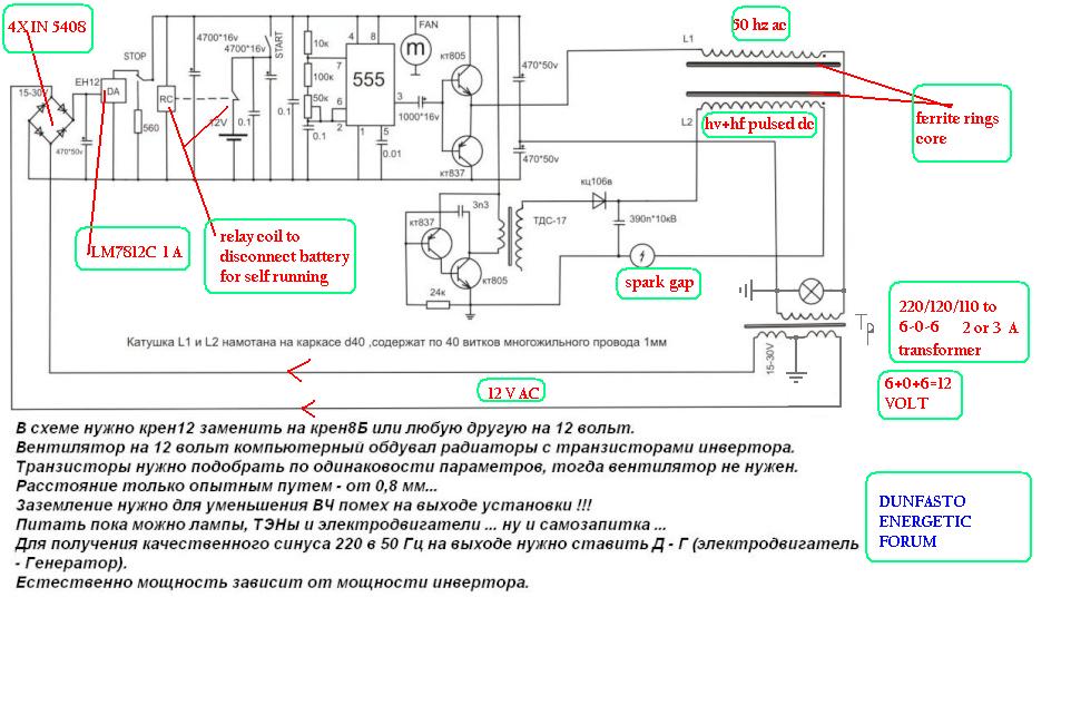

yes its voltage regulator 12 v 1 amp. ic LM7812COriginally posted by boguslaw View PostVery simple circuit ! We should really replicate it.
Do you have idea about the part Eh12 ? is that voltage stabiliser ?
and for higher amperage one can use scaled down version of

Can someone please translate the Russian text in this image (schematic)?Originally posted by dunfasto View Postyes its voltage regulator 12 v 1 amp. ic LM7812C

Hi Dunfasto.Originally posted by dunfasto View Postyes its voltage regulator 12 v 1 amp. ic LM7812C

So the 555 timer outputs a square wave drive to 808+837.
The DC output is level shifted by feeding L1 in series with Tp+load and the series 470uF capacitors between circuit power rails.
808+837 output thus becomes an alternating polarising pulse through L1, though the current flow (magnetic induction) must actually end up being a near triangular wave with fast leading edge alternating spike.
Are L1 and L2 bifilar; one over the other; or separate side-by-side ?
Also what type of ferrite - permeability or resultant coil inductance ?
The drawing does not show where the lower end of the TAC-17 HV pulse transformer is intended to be connected to.
From that diagram it is clear that neither the self sustaining power loop nor any pcb rails can be earthed without causing circuit board failure, and yet there are two Earth grounding symbols. Is this really correct ?
As is, the circuit diagram indicates connecting the self oscillating HV generator power rails between +ve on the pcb, and the junction of the 470uF capacitors via the Earth ground connections, and yet these capacitors cannot pass supply current ?
So something is not right here, and anyone attempting construction might be destined to fail.
Anyone who runs these circuits ever try Tesla's trick of magnets near either side of the spark gap to blow the spark right out of the gap, and thereby minimise longitudinal induction heating between points and stabilise operation ?
Cheers ........... Graham.Last edited by GSM; 09-30-2013, 04:43 PM.

I think there no ferite rings, it is not ferite rings, but plastic tube.Originally posted by dunfasto View Postyes its voltage regulator 12 v 1 amp. ic LM7812C

That schematic can be joke. Here translation "In Scheme kren12 to replace or any other kren8B 12 volts.Originally posted by GSM View PostHi Dunfasto.
The fan on the 12 volt computer blew radiators with inverter transistors.
Transistors need to pick up on the same parameters, then the fan is not needed.
Distance only by experience - from 0.8 mm ... (probarly spark gup distance)
ground needed to reduce high-frequency noise on the output of the divice!
While it is possible to feed the lamp, toasters (heaters) and elektromotors well and selfrun ...
To get hight quality sine wave 220 50 Hz in output should put M - G (motor
- Generator).
Naturally power depends on the inverter power."
So SunofFather,Originally posted by SunofFather View PostThat schematic can be joke.

Hi!Originally posted by SunofFather View PostThat schematic can be joke. Here translation "In Scheme kren12 to replace or any other kren8B 12 volts.

its not joke.
50 hz square wave and high frequency is 27 khz to change high freuqency to another frequency use 4 5 or 6 nano farad cap instead of 3.3 nf. fan needed to cool heat sinks for inverter transistors.

Hi Dunfasto.Originally posted by dunfasto View PostHi!
its not joke.
dunfasto
Look at the oscillator you say is 27kHz.
The oscillator does not have a negative DC power supply and the transformer secondary is not connected. It cannot work !
What kind of ferrite.
Are the coils bifilar, or layer, or side-by-side.
When switching transistors overheat then they are not being used correctly, they should run cool.
Cheers ............. Graham.
