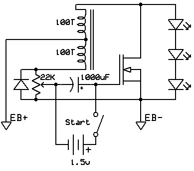

          • Originally posted by janost View Post
            Trick question,
            If you drive the gate with a squarewave, what will be the output of the transformer?
            Tip: It wont be the voltage in the earthbattery chopped up into a squarewave.
            Janost always comes up a step ahead of us. With this transformer, the primary acts as a "spark gap" shorted inductive load to the ground( only when the FET connects). The secondary is isolated from the ground, and can charge a cap bank. I wonder what kind of waveform we will encounter in the secondary side.
            Anyone take the challenge, and give a word?
            aaron5120
            • Answer:
              When the mosfet is conducting, the coil gets charged from the groundcurrent.
              When the mosfet stops conducting and the primary opens, there is a kickback in both the primary and the secondary that is several times the groundvoltage.
              A simple but very effektive dc-dc converter to charge a cap or drive a led with higer voltage than you get straight out of the ground.
              Instead of having a separate osc to drive the mosfet I have integrated the groundloop into the osc.

                • Originally posted by hotrod68r
                  hi janost. how would it go if you used a transistor? also, here's some more blocker circuits.
                  Come to think of if it would work with a transistor.
                  Yes, if you put the drive battery in series with the EB it will run.
                  The kickback should oscillate the ground more than the battery
                  • And yes, earthbatteries are chargeable like a cap.
                    My EB is polarized but with similar metalrods it will be non polarized.
                    With a non polarized EB it might be difficult to get it started because there isnt much of a charge in the ground to get it going.
                    In that case the drivebattery needs to be in series with the EB.

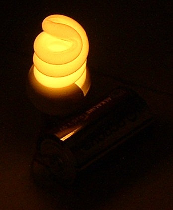

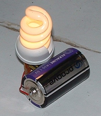

                            • Anyone starting to see a resemblance to the TK coil in this gardenlight version?
                              • At the moment I'm doing an endurance test on one of my 1.5v CFL lights.
                                Just to make sure it has some runningtime
                                I'm wasting the battery to check how long it lasts.
                                My calculations says it runs nonstop for 27h on an D-size battery.
                                Still running
