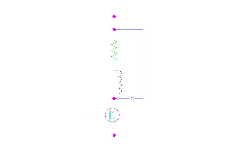

                          • Hi Luc, could you try this circuit since you have that thermal meter device and I only have my fingers to test for speed of temp. rise. If you could pulse your resistor at a certain power draw and measure temp., then use the circuit I am posting and set the power draw to the same and measure the heat. I used a 200 milliohm inductor and 10 ohm resistor so I only had to adjust the 555 pots slightly to make same draw. I have found this gives a much faster heat rise in the resistor although not sure what the final stabilized temperature would be due to not having a meter device for it yet. Thanks.
                            peace love light
                            Tyson

                              • Hi Luc, never mind, the more I'm testing it seems the same as your results although your circuit would be better for running a motor or something. My results were confusing me because the temp. of the resistor wasn't at the exact same starting temp. for comparative tests. Though of course when tuned properly higher heat as in Ainslies circuit would manifest. I'm glad you have highlighted the fact creating the magnetic field in the coil costs nothing as my results show as well though using a little different circuit, great stuff.
                                peace love light
