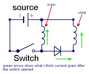

    Hi all,
    see the attchement, i have the circuitry set up as the diagram, but i want the switch-1 "transistorized" so to speak....to give the following set-up...
    PWM pulse - mosfet - switch-1(transistor)
    positive - ON - OFF
    zero - OFF - ON
    in other words, when pwm is positive voltage the mosfet is 'in' circuit but the switch-1 is open and when the pwm goes to zero the mosfet opens up and switch-1 closes.
    im guessing but i think i need a PNP transistor?.... but i have little idea how to wire it as ive never worked with PNP before....not that im an expert with NPN ( an idiot actually )
    i have a couple if BFY51's.but not sure if they will handle the flyback voltage...
    Help very much appreciated,
    Thanks,
    David. D

                  • Forgive me if this had been answered before.
                    What is the resistance of both coil in video bellow?
                    YouTube - Effect of Recirculating BEMF back into Coil test 1
                    I think if the coil-collapse-current powered coil have much less resistance than the main coil, the power will be greater since I think there would be more current passing trough the child coil than bouncing back in the main.
                    I think vibration happen because different polarity between main and child.
