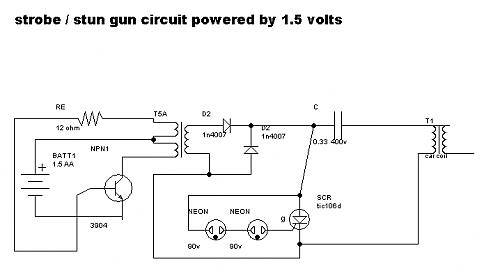

            Could you post your schematic?
            I'm curious how you hook up to the car ignition coil.

              • hv from a double A battery
                i've only played with electronics for a year now so i bet you guys can make this better

                  • Replication
                    @Kooler &All
                    I replicated this circuit with what I had on hand and found it very interesting. It was not an exact replication but I did get some pretty big sparks flying out of the ignition coil. There were two things that I found note worthy:
                    1) You can use a center tap transformer in the Joule Thief circuit ( I used a 12v-0-12v / 117v) and get the secondary winding to produce the
                    HV.
                    2) You can use a neon triggered SCR to oscillate the HV through a cap into an ignition coil to make BIG HV!!!
