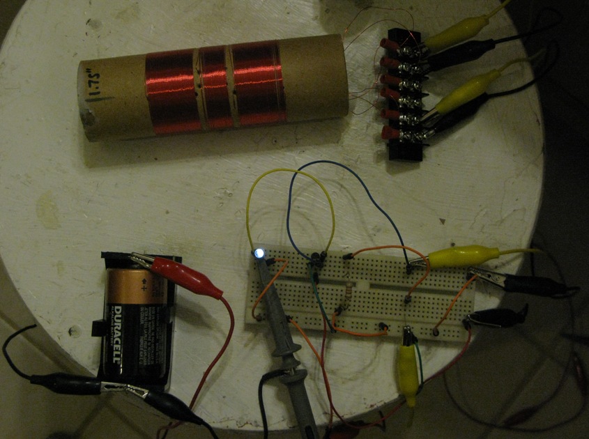

                        • air-coil JT
                          Originally posted by jeanna View Post
                          How is the joule thief connected to D2 and D3?
                          I wonder about the characteristics of this motor... bedini perhaps?
                          Am I mistaken?
                          Didn't lidmotor do this with his new (like a jtc) circuit and saturn magnets?
                          If a certain joule thief only uses 1.2v and 10mA or so and produces 90volts, I am sure it is possible.
                          @jeanna
                          So there are three coils on a common cylinder. I have a 1.75 inch
                          diameter .... If you face the cylinder with either end left and right,
                          then the left most wire of the left most coil corresponds to the
                          dot on one transformer. The left most wire on the right coil
                          corresponds to a dot on the other side of the transformer in
                          the circuit schematic. In other
                          words, preserve the phase relationships ... the wires on the same
                          side of the coil are the same phase ...
                          The Joule Thief SWAPS these phases ... see the dots on the
                          circuit.
                          Anyway, I'm interested in this regenerative oscillation --
                          180 degree phase shift stuff.
                          In searching for various oscillator circuits, I found one whereby
                          there are 3 RC circuits, each to produce a 60 degree phase shift
                          so that the sum total phase shift would be 180 degrees ...
                          JUST to cause the waveforms to be regenerative.
                          The Joule Thief does this simply by inverting the signals
                          on the transformer... giving 90 degree shift ... then run
                          through a transistor .. giving other 90 degree shift.
                          I see that the Joule Thief circuit is just an ARMSTRONG
                          oscillator with some simplifications.
                          See attached figure of classic Armstrong oscillator.
                          re: United Devices motor
                          The motor in that article is interesting.
                          It has a strong ALINCO magnet encased in two
                          IRON structures that don't touch ... but form
                          a hole for the armature to spin in ... one side being
                          NORTH from the magnet ... and one side being SOUTH.
                          The coil for the armature is wound around a cardboard
                          SQUARE shaped structure. It is not wound the traditional
                          way found in a motor .. .but rather its wound more like
                          you would find in a analog voltmeter ... or ammeter.
                          There is a diagram.
                          I imagine this sort of motor as being very sensitive
                          and that it will spin with very low voltage and low current ..
                          with the MAGNET being very strong.
                          In other words, very subtle energies picked up from RF
                          can make it spin.
                          Once it gets going, however, it produces its own
                          local fields that can feedback in to the receiver.
                          If it can be setup to feedback EXACTLY 180 degrees
                          from the incoming waveform ... it could possibly
                          SPIN up faster and faster to some equilibrium.
                          The trick here would be to make a very sensitive motor like that
                          and to make a sensitive RF receiver with full-wave rectification
                          to produce DC to spin the motor.
                          re: lidmotor
                          I don't think Lidmotor has his thing self-powered.
                          His little maggie light is just inductively picking up energy from
                          his other "powered" Bedini magnet-circuit.
                          Please correct me if I'm wrong.
