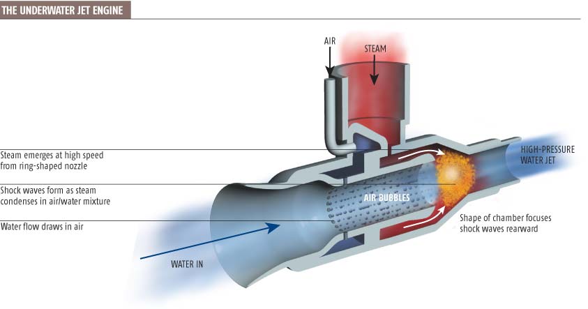

    Research shows Condensation-Induced Water Hammer (CIWH)
    can produce 1000+ psi events with low pressure steam.
    An example of CIWH creates 30 HP (22 kilowatts) from a device less
    than 8" long by 3" in diameter with no moving parts. It mixes steam,
    air and water to create this power. This device ran on 4 bar (58.8 psi)
    steam, but the research might indicate any psi steam will create this effect.
    See image, rough dimensions listed below.
    What are the break even parameters in this energy equation using
    the simplest water turbine at 60% system efficiency?
    If steam at any pressure can move water at 100, 200, ? psi
    could one extract more energy out than put in?
    Create a device with a 1" inlet and a 3/8" outlet.
    Additonal ref. see near the bottom of the web page
    Condensation Induced Waterhammer vs.
    Conventional "Steam Flow" Driven Waterhammer
    The device has roughly: 2.35" water inlet, 1.4" steam inlet,
    1.07" inner diameter water restriction where the
    air is mixed and 0.93" water outlet. I have more diamen

        I thought a device like this has great potential to
        allow water to be used to extract work from steam.
        It's proven to produce lots of power.
        There is very little info on it or it's just hard to track down.
        Study has been concerned with "closed" pipe system.
        I am thinking this device it would pair up with the Friction Steam system well.
        My thoughts were to transfer unfriendly steam energy to the more friendly
        to use water, for work extraction.
        This could be a simple system,
        a rectangular closed pvc tube with water turbine(s) or
        even maybe an open circular tank.
        Depending upon the output, even water wheels might work.
        Easy duplication of a safe to use device is key.
        Creation of a device is first.
        How could one safely measure/guesstimate the water output
        from a prototype device using only a straight 1" pvc pipe and 1/4" steam pipe to start with?

            This is the effect wanted, to move the water using the 1600:1 vacuum
            Originally posted by Vortex View Post
            It's the sudden condensation of the steam which sucks the water in to replace the vacuum created. This is the effect wanted, to move the water using the 1600:1 vacuum.(volume of steam to volume of water).
            Randy

                    How To Get Steam, WITHOUT Building a Full-Blown Boiler
                    Get steam some how, without building full blown boiler, make a prototype, test it.
                    I'm thinking about how I'm going to create the steam.
                    Randy
                    Hi Randy,
                    The easiest way I can imagine is to use a steam powered wallpaper-stripper!
                    These will generate more than enough steam for trials. I don't think you will need much pressure to test the theory out. Some types use a car radiator pressure cap as a combined filler and pressure release valve, so you can change the pressure cap if reqd..
                    Plastic pipe would be the easiest material to build a test device. Using a 'swept tee', (see picture below) would be a good way to start construction. I have no idea where you live, but in the UK we use 32mm and 40mm for sink and bath water waste pipework. It is very cheap, easy to cut and work with and the solvent type allows strong bonding to assorted fittings using a solvent-type adhesive which virtually welds the fittings together. There is also 15mm and other sizes up to 120mm and beyond.
                    Only ONE major problem to be aware of - It is NOT designed for steam temperatures!
                    However, if you use copper pipe to deliver the steam into the mixing chamber, I think it may work.
                    I am sure I could assemble the copper pipework as reqd.
                    If this fits in with your ideas, let me know and I will locate the parts and build a few to test out along with any suggestions/designs you wish to try out.

                      Curious if injecting steam into water without any device would you see
                      steam Bubbles?? With pure steam, I think you shouldn't ..
                      Ah, but if there be air mixed within the steam you would see bubbles.
                      We need to Baby step these tests, they should go pretty quick.
                      Sizes of tubing depends upon the pressure and volume of the steam
                      Too big is best at first. For oh, big time guessing here, 10 psi and less,
                      1/4" copper tube centered in a 1" pipe could be
                      too small / restricted for an initial test.
                      Bigger is always better until it becomes known what is to be expected.
                      Any kind of tube for the outer tube would work at first, it might even
                      collapse and that would be cool. The outlet of the copper tubing
                      should be at back from the outlet end about 1/2"..
                      Oh Oh. I have an image with measurements...
                      The initial test should just use a straight piece of pvc pipe. .. If air is
                      being sucked into the inlet, bend it downward into the water. If any volume
                      is being moved, Then flare out the inlet using a paint stripper or stove and needle nose pliers.
                      Insulating the inlet steam tubing wouldn't hurt with just about anything
                      to keep the cold water off the tubing.
                        Jove,
                        I'm still thinking I might be able to pull this off with just tubing, look at
                        image.
                        That's a idea I've been pondering over and have not tested out yet.
                        That's what I've been thinking about
                        Randy

                          Originally posted by byjoveoldchap View Post
                          I have enough plastic and copper pipework, fittings and spares to build something quickly, all I need is a better understanding of the specific effects caused by the device you have highlighted so I can understand the mechanics precisely.
                          Hydraulic horsepower = Flow Rate(US gal/min) * Pressure(psi) / 1714
                          HP = (F x P)/1714
                          Water equation: Power = Force * Velocity
                          Power in watts, Force in psi (water head) and Velocity (or flow) in liters per second.
                          W = H x F
                          Water head or Hydraulic head: 2.31 feet of water height is 1 psi. We are looking to condense steam
                          to obtain psi and flow.
                          The mechanics can be reproduced using a driving fluid of air, water, steam,etc. It's just the steam has a 1 to 1600 condensation leverage
                          over using air or water. The psi of air and water matters. The psi when
                          using steam is a smaller factor due to we have the leverage of condensation
                          working for us. There is the question of: "As steam psi increases how does that effect the output psi of the water?"
                          It's like a Siphon, Siphon - Wikipedia, the free encyclopedia action in that a
                          low pressure is created that sucks in the water.
                          It's the Venturi effect - Wikipedia, the free encyclopedia
                          A paint sprayer sucks up the paint using air as the driving fluid.
                          A the device connected to a water faucet and used to empty a water bed using water as the driving fluid.
                          First learn what sticking the steam sprayer into a bucket of water does.
                          That will show you what forces and reactions to expect from "your" steam
                          source. Nozzles (reducers, reduction in pipe size) will increase pressures.
                          Expansion of the pipe will lower the pressures, a tee off a larger pipe would
                          allow a reduced flow and vent the rest of the steam away from the test device.
                          Strap down your sprayer to prevent kick back when the trigger is opened.
                          You don't want to be out of control during testing.
                          You are going to need something a little wider than just a bucket.
                          Something a foot across at least, wider would be better. We only need
                          a few inches deep for testing I would think.
                          I am thinking about some really simple ways to test this out and observe the action clearly. As you say, rubber tubing will do just to get a taste of what happens and go from there.
                          Yep, slow steps. build upon experiences.
                          I don't want to replicate exactly the design as per diagram, but use my own mind to determine a simple way to get the effect and utilise it.
                          Oh, no. The goal isn't to reproduce that device. That's only a
                          reference of what works using 58.8 psi steam to create 30 HP.
                          Reference for what to try or work towards adding to a device.
                          That kind of HP isn't the goal.
                          Only reproduce the "mechanics" as you put it, of moving the water.
                          Learn the parameters and ratios. Learn what increases flow.
                          I believe the psi or head in "water speak", the output psi of water is the goal.
                          Turbines are like supercharged water wheels, liking higher PSI.
                          The high PSI can always be converted / downgraded to move larger volumes of water as needed for a water wheel.
                          Any water device could be used to extract work, it's a matter of level of
                          degrees: cost, tech, materials, ease of construction, complexity, SIZE! , etc.
                          Water wheels are low tech and simple but are larger and
                          add the need for a water pump(s).
                          Turbines are higher tech, more complex but could be configured without the need for a water pump(s).
                          A Pelton wheel - Wikipedia, the free encyclopedia is ideal
                          but a perpelor turbine Kaplan turbine - Wikipedia, the free encyclopedia much simpler to use and create.
                          Simplest of all, if found to work, would be a circular
                          tank with a horizontal water wheel in the middle, no water pumps. The configuration of the system is like this, but without the gravity force
                          Gravitational Vortex Power Plant is Safe for Fish : TreeHugger
