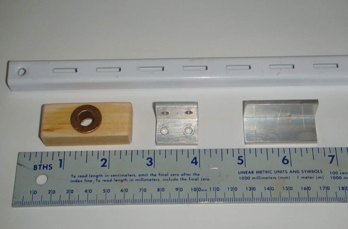

        I'm attaching a photo showing some of the support elements. At top is one of the two 3-sided steel support columns that will be used as the uprights. These measure .650 inch x .428 inch x 24 inches in length. These are very strong and rigid. You might recognize them for what they are. These would normally be mounted to a wall or cabinet interior, and shelf brackets would be inserted in the slots at a desired height. There are actually three mounting holes along the length of the upright, though only the top one is shown at left in this photo. The bottom hole, at the opposite end of the upright, will attach to the 1 and 5/8 inch piece of aluminum "L" stock shown at right, using a single screw, and the "L" stock will be mounted to a 3/4 inch thick x 12 and 11/16 inch x 24 inch birch plywood base using two screws. The shorter piece of aluminum "L" stock will be used at four locations of the build as anchor points for 1/8 inch x 3/4 inch wide flat aluminum stock that will connect to the uprights (two per upright) at an angle, to stabilize them. A 3/8 inch x 1 inch x 2 inch wooden block, as shown at left, with a 1/2 inch hole drilled at center, is fitted with a flanged bronze bushing with a 3/8 inch inside diameter. This will be attached to each of the uprights using two screws spaced 1 inch apart, and the screws will pass through the two slots nearest the top end (adjacent to where the block is now located). In other words, if you were to pick the block straight up, then move it over and place it on top of the upright, that would be the mounting position. Attaching the blocks in this manner allows the bushings to be moved up or down in order to achieve best alignment with the 3/8 inch x 6 inch shaft. Aside from the elements shown and/or mentioned, there will also be six shaft collars that attach to the shaft with set screws. Two of these collars will ride up against the bronze bushing flanges near the ends of the shaft to eliminate side play of the shaft, and the other four, when combined with large fender washers, will ride up against each side of the two wheels, acting as hubs. I will also either pin or bond these hubs to the wheels to offset the wheels by 30 degrees. That covers everything I'll be using for the supporting fixture. I'll post another photo in a few days showing the assembled fixture.

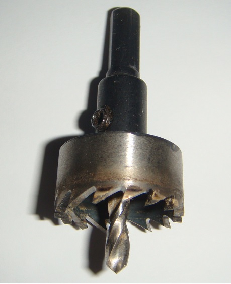

          Below is an image of the 27 millimeter boring tool that I used for drilling the pipe attachment bore holes. The pilot drill for this tool is 3/16 inch. While this appeared to be an ideal tool for the intended use, I found that, while cutting, the space between teeth loads up rather quickly and that I have to keep cleaning out that material since it has nowhere to go. Also, I found that even though the hardboard panel is only 1/4 inch thick, it was difficult to drill more than half way through the panel without burning the material. Thus, I found that the best solution was to drill just half way through one side and then flip the panel over to finish drilling from the other side. For a larger size build I would definitely prefer using an adjustable cutting tool.

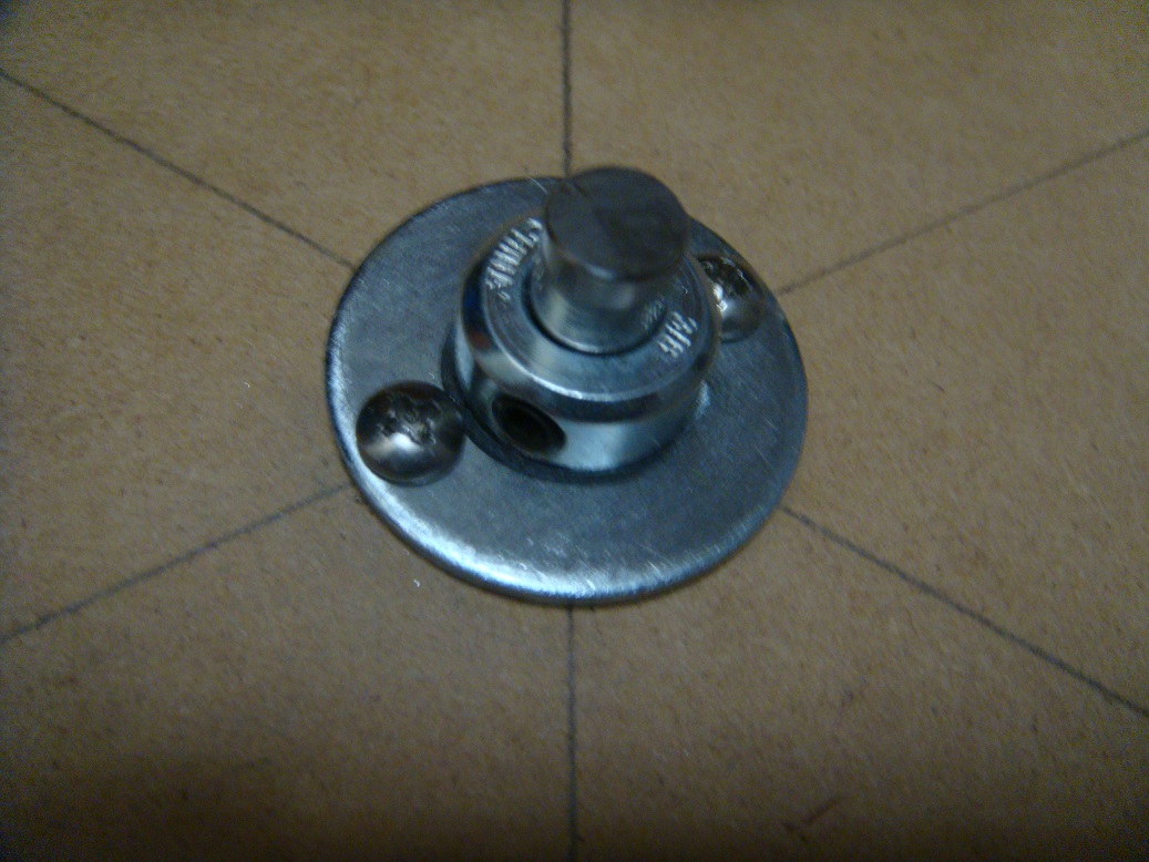

            Here's a photo showing what I decided to use for the wheel hubs. What you see is a 3/8 inch inside diameter shaft collar having a 3/8 inch width and 3/4 inch outside diameter, fitted with a shaft attachment set screw which you see exposed. The shaft collar is bonded to a 1/8 inch thick, 1 and 1/2 inch diameter fender washer using a clear 5 minute epoxy. Each wheel has two of these hubs sandwiching the wheel center, and are drawn tightly against the wheel by the two #8-32 pan head stainless screws seen in the photo, and fitted with flat washers and nuts on the opposite side. I pre-drilled two of the fender washers with a 5/32 inch drill bit using my bench top drill press, then inserted the 3/8 inch shaft into an undrilled hub assembly, through the center hole of the wheel, and on through the drilled hub assembly. Locking the shaft collars onto the shaft, I then used the pre-drilled holes as a guide to drill through the wheel and the undrilled hub washer. By the way, I had actually only inserted the shaft as far as the tip of the shaft collar before drilling so as to prevent any damage to the shaft from the drill chuck, and then extended the shaft further out before taking the photo. I had originally planned to use only one hub assembly for each wheel, but decided on using two for additional stability. With the two screws passing through each wheel and locking the hubs together, there is absolutely no chance of a wheel breaking loose from a hub, or the two wheels drifting out of proper alignment with each other. I would have preferred using 1/8 x 2 inch fender washers if they had been available, as this would have allowed more space between the screws and the shaft collars, but couldn't find larger ones locally. I also would have preferred using Torx star drive screws rather than these Phillips head screws, but made do with what was available. Two more shaft collars will be used near the outer ends of the shaft to ride against the bronze bushing flanges in order to eliminate any side play. My next step will be to lay out the attachment areas on the wood base, and to attach the 6 anchors, 2 uprights, and 4 stabilizer links.

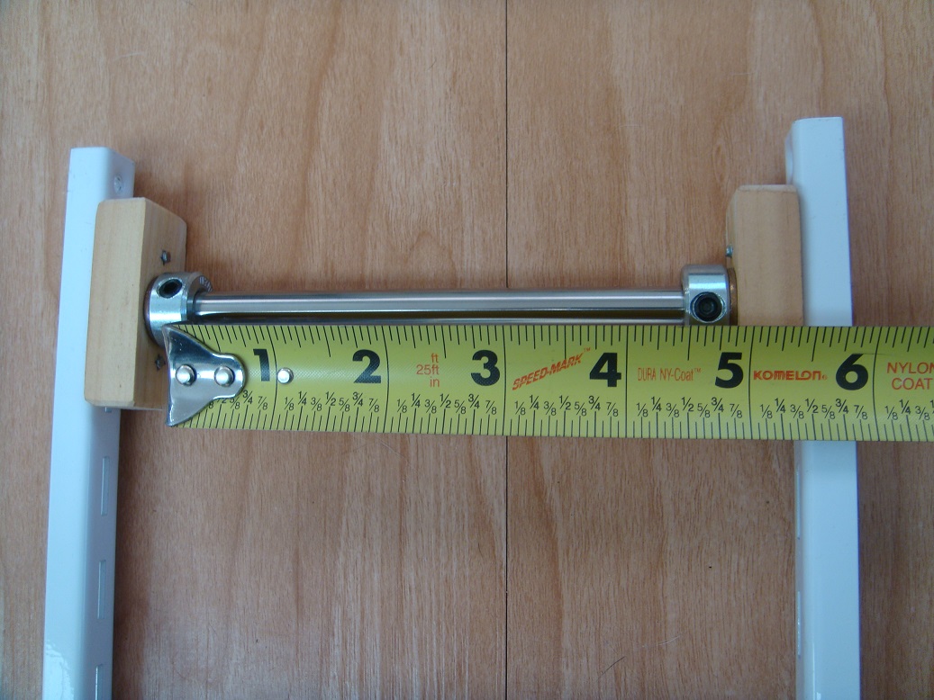

                    I had a little extra time today to assemble the flanged bushings on the uprights, and mounted shaft collars on the 3/8 inch x 6 inch shaft, leaving 3/8 inch of shaft at each end to be inserted into the bearings. Assembled in this manner, this leaves exactly 4 and 1/2 inches of unoccupied shaft space between the inside surface of the outer shaft collars. It would appear, when looking at the below photo, that the space is about 1/16 inch less than that, but this is because of the angle of viewing. The 4 and 1/2 inch space will be more than enough to accommodate the two 1/4 inch thick wheels and their hubs, spaced 1 inch apart for the pipe end caps clearances, as the overall length of this wheel and hub assembly will be 2 and 1/2 inches.

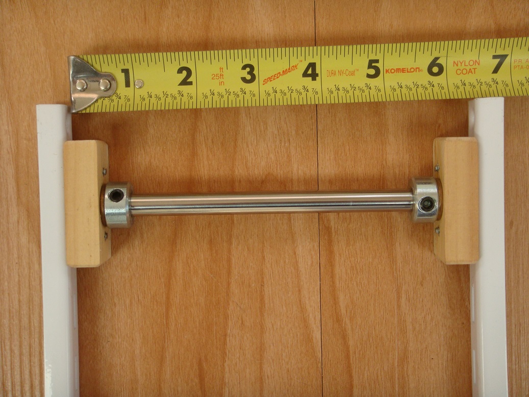

                      The remaining question to be resolved is whether or not the 3/8 x 6 inch shaft will be long enough to allow adequate space between the uprights so that the pipes, when assembled to the wheels, will not run into any interference from the uprights when the wheels are turning. Since the wheels are 1/4 inch thick, and there is an intervening space of 1 inch between the two wheels, the dimension between the outer surface of the wheels will be 1 and 1/2 inches. At those outer surfaces, there will be a 90 degree pipe elbow extending an additional 2 inches, and thus the overall width to be concerned with will be 1.5 + 2.0 + 2.0 = 5.5 inches. As can be seen from the photo below, the actual clearance is 6.375 inches, or 6 and 3/8, so there is more than enough space. In fact this will leave a 7/16 inch clearance between the pipe elbows and the uprights at each end of the assembly.
                      Knowing the spacing between the uprights is 6.375 inches, the wood base can now be laid out for the placement of the feet that will be attached to the bottom end of the uprights, and the 4 anchors that will be used to connect stabilizer links between the anchor points and the uprights. I'll show the layout lines, with upright feet and anchors attached to the base, in my next post.

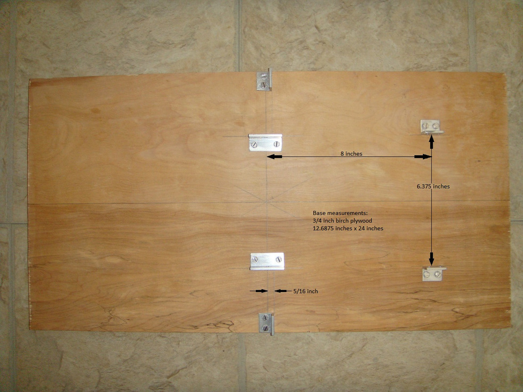

                              I was able to lay out the birch plywood stock that I am using for the supporting base, and attached the two feet that the uprights will be fastened to, as well as the four anchor points which will be connected to the uprights by stabilizer links. I added measurements, after capturing the image, for reference by anyone interested in the build. Note that the 5/16 inch measurement is half the width of an upright, which is 5/8 inch wide. The two anchors 8 inches from the uprights will be connected at the mid height of each upright, where a hole already exists. The two anchors at the outer edges of the base's center line will be connected to the right side of the uprights at a lower point. It will appear, when looking at the photo, that the outer edges of the base board are somewhat curved, but they are not - it is an effect caused by the camera lens.
                              I used #6 x 3/4 inch sheet metal screws (0.163 inch diameter) to attach the feet and anchors to the base, and pre-drilled the screw holes using a 7/64 inch drill bit (0.107 inch). As you can see, the base is 12.6875 inches wide, and the reason for this was because, when cutting from what I had remaining of the birch plywood, this was the maximum allowable. I would actually have preferred a 16 inch width, but figured I'd make do with what I had on hand. Each anchor has two mounting holes for attachment to the stabilizer links, so even the shorter links should provide good stability. The reason why I am only anchoring at one side of the apparatus is mainly because I wanted to leave the left side view unobstructed by any stabilizer links. I feel that the current support apparatus, with stabilization triangulated for each upright, will be more than adequate. After all, if this works as imagined, the wheels will be turning slowly, and the amount of water being used in this build will not produce much of a sloshing effect.
