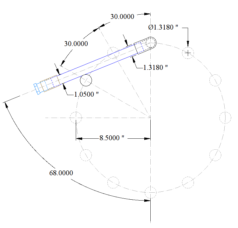

            • #21
              Rickoff,
              Here is the CAD layout. The radius works out to 8.5" to get the desired 68 degree angle.
              Pipe OD = 1.050"
              Elbow OD = 1.318"
              The circles are equal to the elbow OD to show the contact point between pipes.

                • #23
                  Hi Cadman,
                  Thanks for your CAD drawing. After seeing that your drawing comes out to 8.5 inches as the necessary distance from the wheel center to the bore hole centers, I decided to check the angles shown in my last post, and to make corrections to the drawing as necessary. I had previously taken the angle readings from my True Angle tool using my eyes, but this time used a magnifying glass. The degree lines, marked on a 1.875-inch diameter circle, are very accurate but make it difficult to read accurately unless the angle falls directly upon one of the degree lines. Using the magnifying glass helped quite a bit in estimating 1/4, 1/2, and 3/4 degree angles between the marks.
                  I went back to my drawing and added circles for the 8.5-inch specification and, after making several angle measurements to assure precision, I came up with 68.75 degrees. My measurement for the 9-inch bore hole came out to 68.25 degrees. This made me wonder why the CAD drawing is at variance with my manual drawing. Not that a 3/4 degree difference is enough to worry over, it's just that I rechecked the angle between my radian lines and found it to be a perfect 60 degrees, and my inch marks on both radian lines were also very accurate. The photo of the drawing makes it appear that some of the lines are not quite straight, and that the vertical and horizontal lines are not quite at a true 90 degrees, but these are distortion effects caused by the camera lens. The only explanation that seems to make sense for the variance is that while I attempted to draw the circles as close as possible to the actual 1.050 and 1.318 specifications, using a draftsman's compass, it appears that they came out to be slightly larger than intended. If either circle is drawn larger than specified then of course the lay line angle would be larger than if the circle had been precisely sized, and if both circles are just ever so slightly larger than intended (which appears to be the case) then this could easily account for a 3/4 degree difference. Thus, your CAD drawing is probably highly accurate.

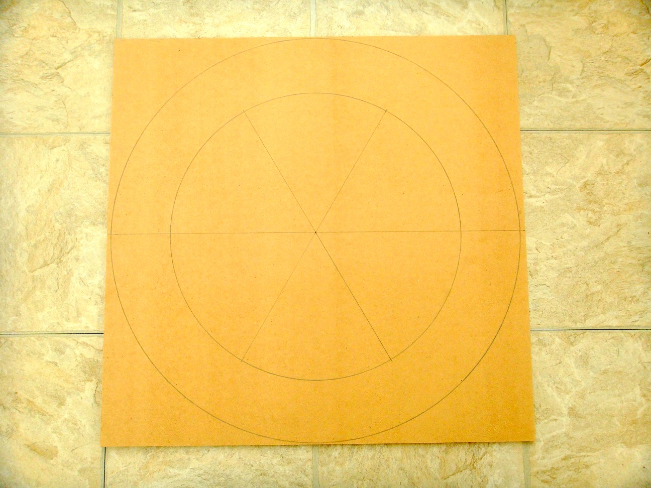

                              Project continued...
                              Very sorry for the delay in continuing postings with updates on the 3/4 inch build. Some folks may have thought that I had dropped off the face of the planet Earth, but that didn't happen. I did, however, run into what seemed like one thing after another that continually either distracted me or took precedent, including the unexpected death of my younger brother late in March. I see now that it has been nearly a year since I last posted. I had to read through my thread to refresh my mind as to what I had already shown. Although I'm still not entirely "out of the woods," so to speak, and have several more things that I must attend to before the cold weather sets in, I decided to at least get a head start today on moving the project along.
                              I had already purchased two sheets of 24 inch x 24 inch hardboard for constructing the larger wheels I had talked about. These wheels are laid out for a 24 inch diameter, and with an 8.5 inch radius bore hole circle, which is the dimension that Cadman determined (see his 06-11-2018 10:07 AM post) would result in a 68 degree from vertical lay angle for each of the pipes. There will be 6 bore holes cut into each wheel, so the radian lines are drawn at 60 degree intervals. The two wheels will be positioned upon a 3/8 inch diameter shaft, and spaced as close together as the construction allows. (about 1 inch, as previously figured). I'm attaching a jpg image file so you can have a look at the layout lines for one of the two wheels, which are of course laid out identically.
                              The wheel layout and cutting process is the same as covered in my post # 19, except of course that the diameters of the inner and outer circles are larger for the wheel now being shown. Previously the inner circle was drawn at a 4.5 inch radius, and now we have an 8.5 inch radius. That may seem like an extensive increase just to get from the previous lay line angle of 73.75 down to a 68 degree angle, just a 5.75 degree difference, but as I noted in post # 23, the further out the bore hole is located from the center of the wheel, the less effect it has on the change in angle.
                              A 68 degree from vertical lay angle is what I had estimated would be optimal, as it would allow tube A, as seen in post #2, to have moved all its water to the left side of the vertical center line when the bore hole center for that tube is located 15 degrees before the vertical center line with the wheel turning counter-clockwise.
                              The 27 millimeter bore holes will be centered on the inner circle, at the points where the radian lines intersect that circle. After I cut out and true the wheel, and drill the bore holes, I'll begin the process of assembling the pipes onto both wheels and fitting the wheels to the 3/8 inch diameter shaft. I may do this with the smaller wheels first, just to prove whether or not that version, with a lay angle of 73.75, was adequate for continuous motion. As I had mentioned in an earlier post, the end caps can be attached to the elbow extension of each tube using silicone sealant, which will allow me to remove the end caps later and change over to the larger wheels. The supporting base and uprights will be the same for either build, so changing out to the larger wheels will be relatively easy.
