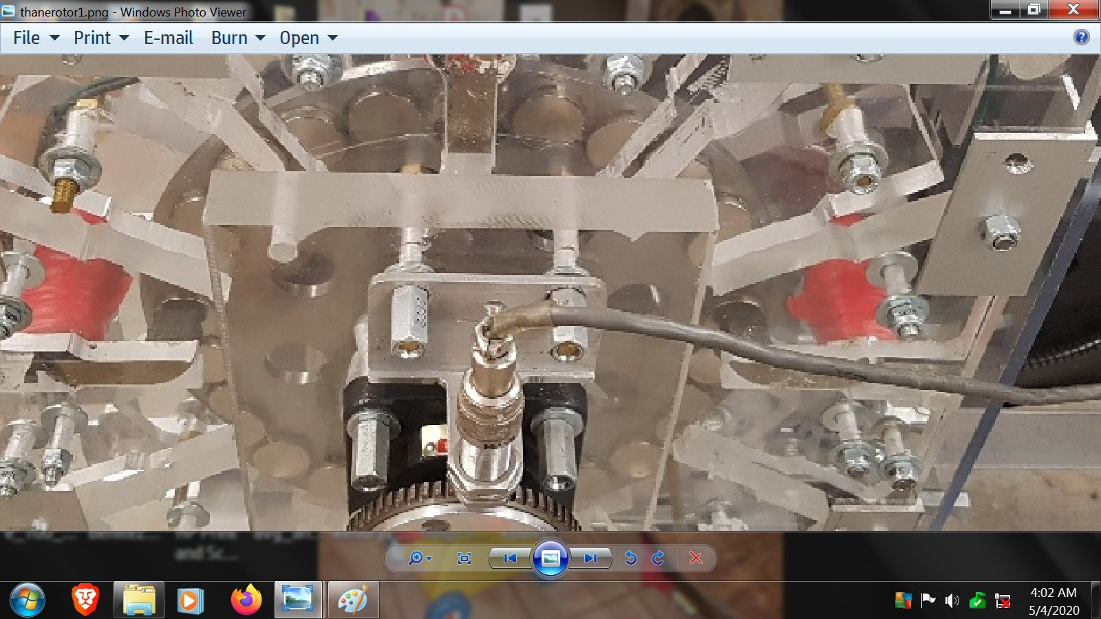

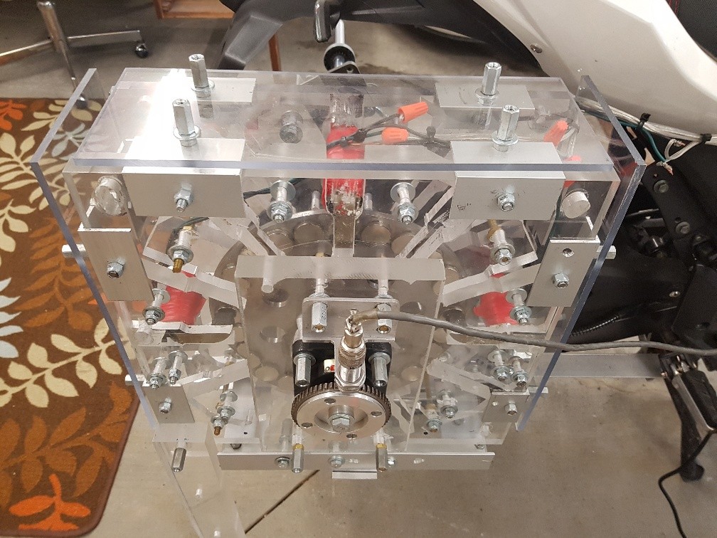

The fuss isn't about the fact that the magnetic field makes it go faster. The fuss is about the fact that all the shielding of the magnets you are doing PROBABLY isn't necessary because something GOOD is happening with the unshielded magnets on both alexelectric's machine and mine. The rotor on the machine in the video and currently on my machine is the rotor with the magnets out at the rim also. But it is a THICKER rotor.
Any rotors on a machine with 12 coils has 12 generator magnets on each side. It also has 12 opposition magnets on each side.
Any rotors for a 10 coil machine only needs 12 magnets on each side.
I don't know if I mentioned this, but Greyland reduced the air gap between the rotor and the coils on the machine, and the opposition magnets were no longer able to neutralize the attraction of the rotor magnets to the iron cores of the coils, so he had to move the coil holders back to their original positions. On the final build, we will move them in again to as close as possible, since the gains in output are exponential when you do that, and use thicker opposition magnets, which will give us a stronger repulsion field.

Those numbers were for my original big machine. I replaced the rotor on that machine with a thicker rotor for a couple reasons. The first reason is that the plastic I was using was 1/2" thick, and when Greyoland drilled holes on each side of the rotor for 1/4" magnets to go in, but left a bit of plastic in between the holes so the magnets would be attracted to each other THROUGH the plastic, the magnets stuck out just a bit on both sides of the rotor. At the time, I didn't think anything of it. The day Peter Lindemann came to see me, I had a rotor magnet that was sticking out hit something at 2800 rpm and the rotor exploded. So changes were required. AND, a thicker rotor doesn't flex as much, so closer tolerances are possible. Because I was going to a thicker rotor ANYWAY, to make sure the magnets would be flush with the rotor surface, I decided to go with thicker magnets (24 1/2' thick magnets instead of 24 1/4" thick magnets, the amp draw went up, so the required input went up. But then again, so SHOULD the output.
So the numbers won't be the same with the machine I have NOW. I haven't measured total output on this machine yet, but I know two coils in series at 2800 rpm were blowing up 300 watt light bulbs, so that's a good sign.
