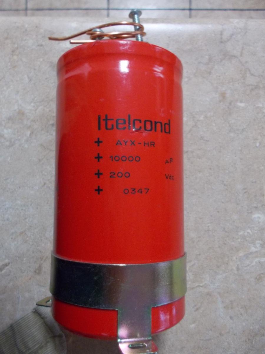

Clarence, I would suggest looking at surplus and used suppliers. Recently found some of these at a Ham swap for $8 each : 10000 uf 200 VDC (about 6" tall) I would also contact these people or look at their web site : HSC Electronic Supply - Silicon Valley's Electronic Marketplace which is HSC Electronic supply in Sacramento, California. They have a huge amount of surplus electronics and generally very good prices as they get much of their supply from excess in Silicon Valley. I've bought a lot from them in their brick and mortar store and they have some real deals that are hard to beat. It just will be the luck of the draw though as to whether they have exactly what you need but I'm sure there are a lot of surplus stores elsewhere.Last edited by ewizard; 12-06-2015, 06:39 PM.There is no important work, there are only a series of moments to demonstrate your mastery and impeccability. Quote from Almine
Hello E,Originally posted by ewizard View PostClarence, I would suggest looking at surplus and used suppliers. Recently found some of these at a Ham swap for $8 each : 10000 uf 200 VDC (about 6" tall) I would also contact these people or look at their web site : HSC Electronic Supply - Silicon Valley's Electronic Marketplace which is HSC Electronic supply in Sacramento, California. They have a huge amount of surplus electronics and generally very good prices as they get much of their supply from excess in Silicon Valley. I've bought a lot from them in their brick and mortar store and they have some real deals that are hard to beat. It just will be the luck of the draw though as to whether they have exactly what you need but I'm sure there are a lot of surplus stores elsewhere.
Really glad to hear from you!
I pulled up the site you mentioned but at the moment they didn't have anything I could use. however I bookmarked it for later off and on.
for frequency control I can only use ACV capacitors usually rated for both AC and DC usage. I have two options bookmarked now from Digikey. one is for 400uf 250acv (at 91.00) and the other is for 150uf 250acv (at 48.00).
so that would amount to 3 @ 91 + 1 @ 48 = 321.00 which is a chunk!
the 1350uf with a total inductance of 5.11 mh (TBC of .11mh and
2.5mh+2.5mh from each leg of a common mode inductor choke coil) will set a frequency level of 60.59 HZ.
so that in a nut shell is what I am aiming for.
As I said E, it is good to hear from you again. stay close!
Respects,
Clarence
