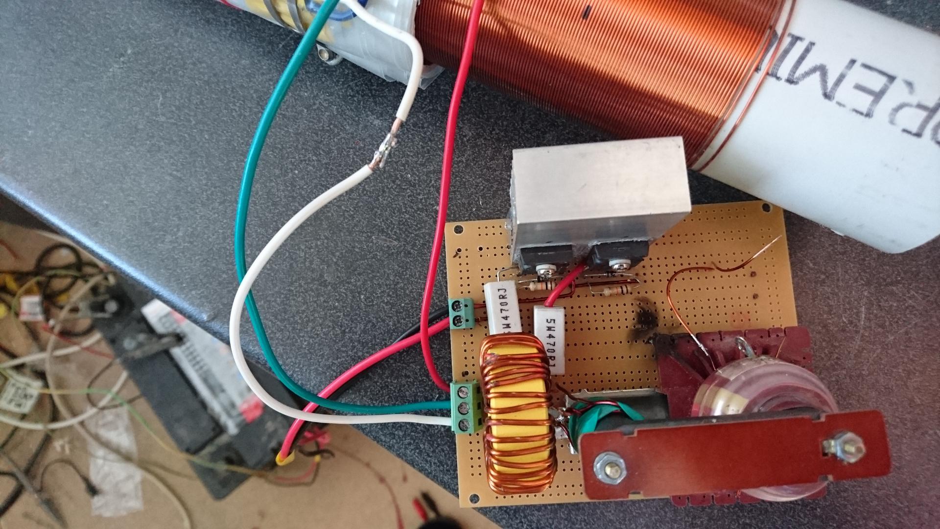

              • Hi Med.3012,
                Have a small issue with the Mazzilli driver. Running on its own terms with the 0.68uf tuning cap, runs just fine. As soon as I disconnect the 0.68uf cap and connect the ETBC, I have a radiator, more like a short circuit across the fets. Also, I am reading 10+Mhz at the Mazzilli!!
                Hmm...
                Dwane

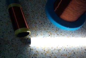

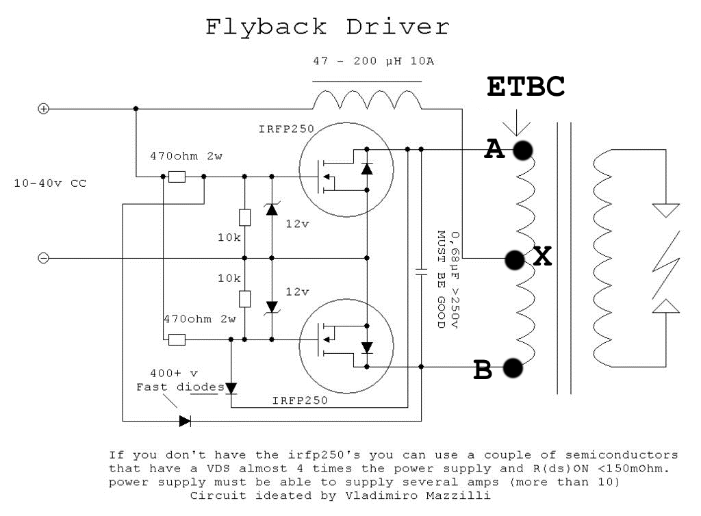

                • Hello Dwane,
                  the proposed ETBC should work just fine with Mazzilli driver , i
                  tested another ETBC with a ferrite rod all the night and it work good,
                  yes the MOSFET will get hot slightly, i am using IRFZ44 since they put
                  a relatively small power into the circuit, just verify the isolation
                  of ETBC open X junction and measure the capacitance also measure the
                  inductance through AB the whole coil, find the resonance frequency
                  using coil32 software for quick results, multiply this frequency with
                  2 , FX2 = THE RESONANCE FREQUENCY OF ETBC, mazzilli driver
                  sould work around this value, also verify your geometry maybe there's
                  error in connections, for example you have a red and a black foil that
                  form the ETBC before you connect them the most important is the
                  position of X junction which have to be like Tesla bifilar .. we just
                  use foils instead of wires !
                  the best frequency that suit the ETBC in Mazzilli driver should be
                  below 2 MHZ , i have an ETBC work in 1.6 MHZ the following photo show how bright fluorescent tube.
                  • Partial working
                    Hi Med.3012,
                    Thanks for the advice. I have isolated the ETBC and the Mazzilli coils using capacitors. If I do not use capacitors the fets will blow! I have the connections as you have stated them to be. With the new connection I think I might be under 2Mhz at the tower or close to it. The ETBC is now ringing at just over 1Mhz. The wave form is unique and not sinusodal. More like a series of damped waves. I get one good wave then a sort of half wave. Does not seem correct. There is a good build up in the centre of the tower. Well I think there is.

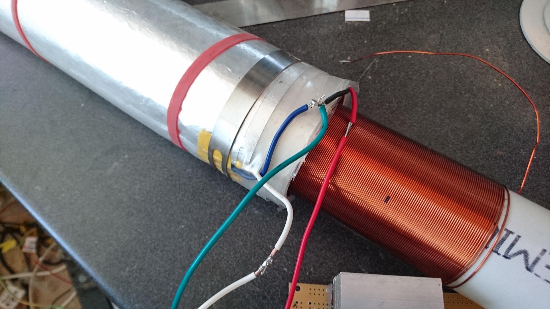

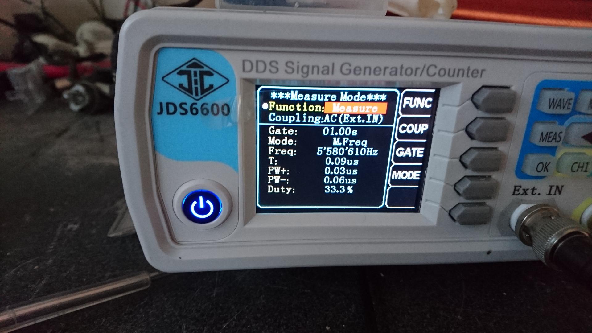

                      Hi med.3012,
                      i have attached images of the set up and wiring.
                      Red = A
                      Blue = C
                      Black = D
                      White = B
                      according to the Mohammed.pdf. Or a bifilar connection. I have unrolled the ERBC as the photos show and the colours of the wires and their location. The foil is wider than your specification of 200mm wide.Length is same. I have used Heavy duty builders film 100um. The foil is heavy duty "Super Strong" kitchen foil. I have taped the solder joints in case they might have penetrated the film when bound. Meterering shows no cross connection before bifilar jointing.
                      I have run this again and the frquency is maddening. I have removed the caps and run directly as per your instructions for connecting to the Mazzilli. The Frequency counter starts off at 5+Mhz and progresses up to 17+Mhz, by which point I am unable to see the waveform on my old scope. The fets - i am using IRFP460 as I have blown the IRFz44 up! At 17Mhz I have turned the unit off! It is begiining to get too hot! The frequency is puzzling. I have 5 + 5 turns on the ferrite core. And, I think my ETBC should be reading a greater capacitance than your 200mm wide: and especially as I have wound on a smaller diameter forme.
                      I am reading 9uH fr the ETBC coil and not that I am convinced, .377uF for the capacitor component.
                      I am wondering if the frequency runaway is due to the 460's not being able to cope with the current flow.
                      This is where I am at.

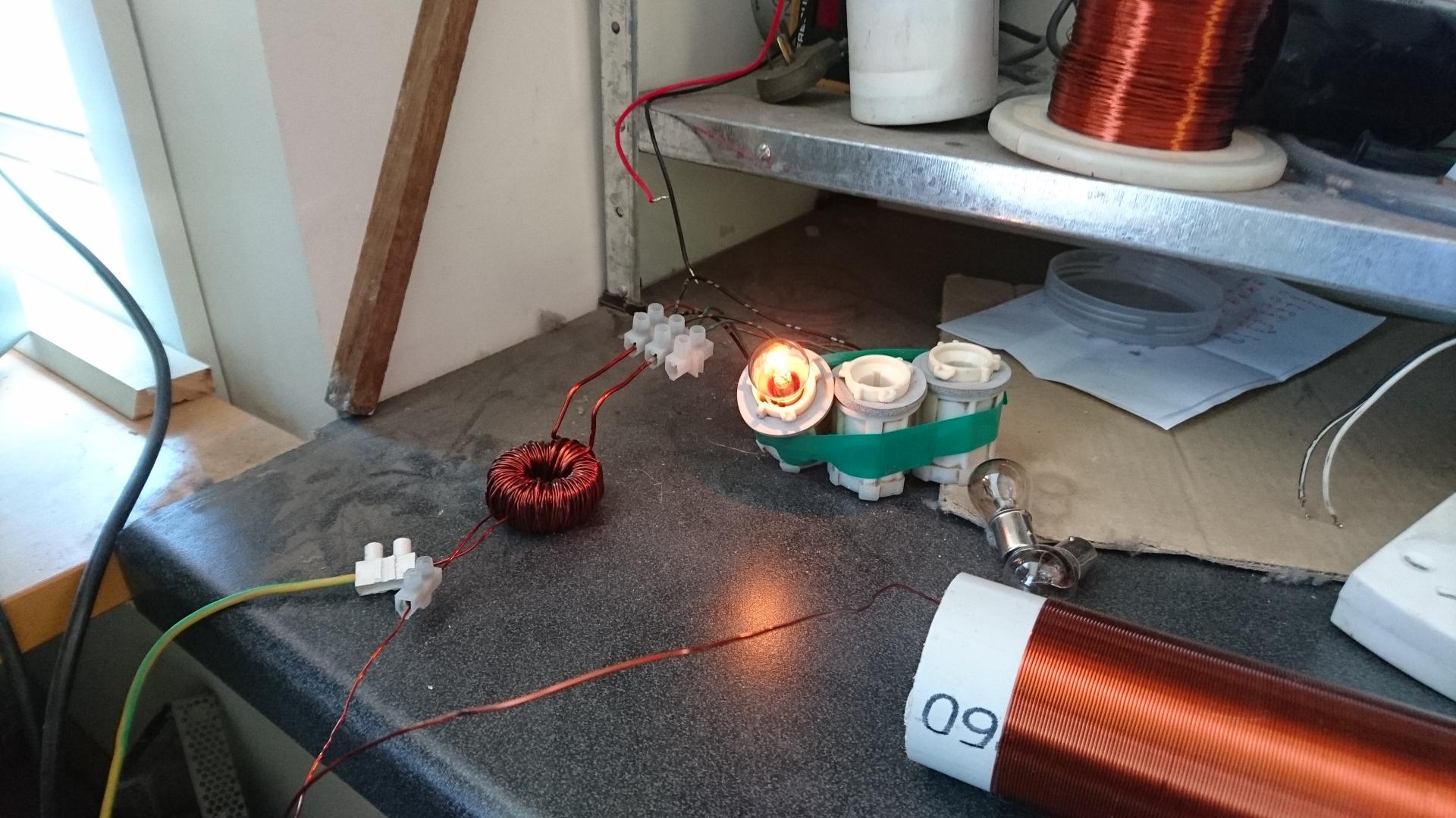

                      • Amazing!
                        Hi med.3012,

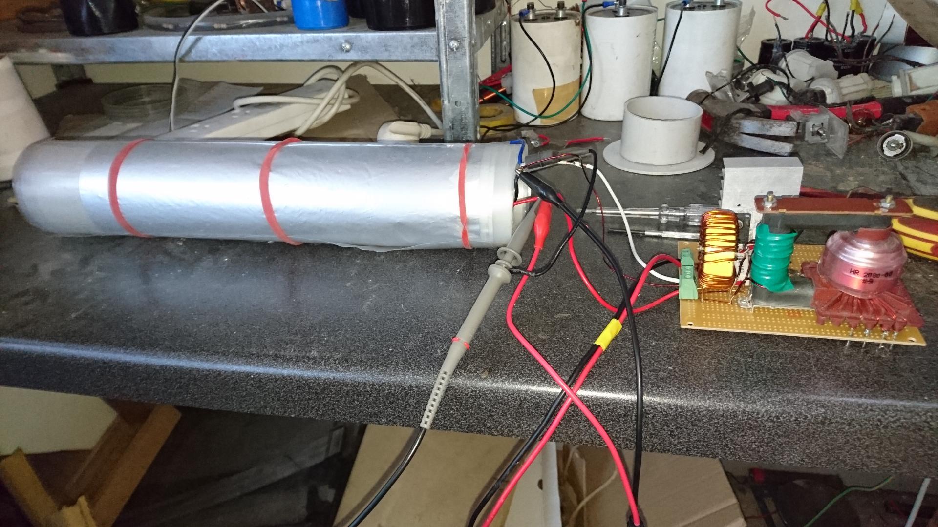

                        as the photo shows this is working for some reason I cannot explain at the moment. Leave it alone for a couple of hours and it comes good! I have turned it off. The fets are sizzling. I have to get a fan forced heatsink set up and some new fets. What is still a problem is that the ETBC unit is running at 6.33Mhz! My tower, I have no idea how fast that is running. Not going to put my counter across it!!
                        Evidence below!
                        Dwane

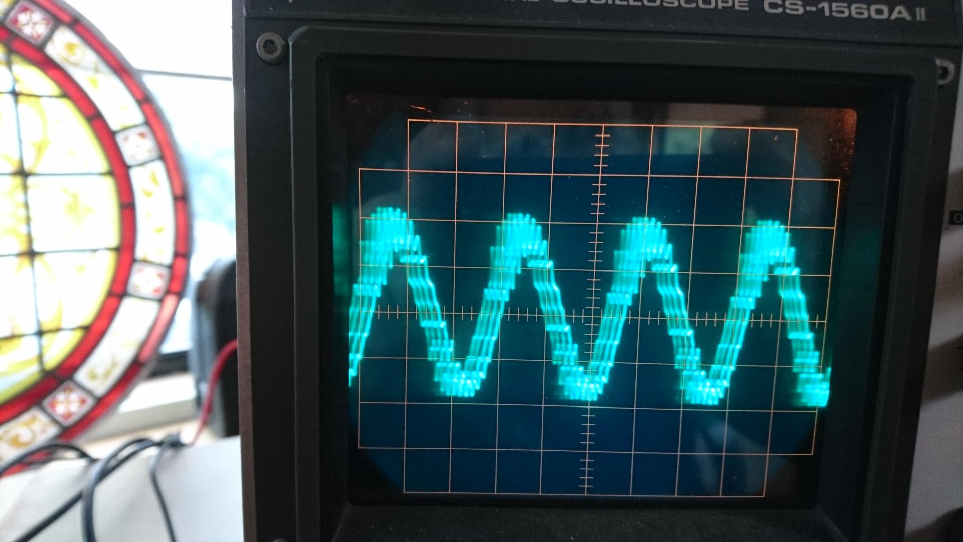

                        • Hi med.3012,
                          The cicuit is running at arounf 500Khz, according to the scope. The "radiation from the set up is perhaps sending mixed signals to the frequency counter. The ETBC has an inductance of 62uH and a capacitance of .115uF. Approximately 60Khz.
                          Now, when I have the system running and the globe lit, all we have is a straight forward transformer conversion. at low brightness, the system will run all nightTo prove this, all I have to do is touch the tower coil and the globe doubles in brightness. if I continue for a minute or so the fets blow. That tells me that the globe is only being lit by the available energy being supplied to the system. Maybe this will change at higher voltages, because higher frequency alone, at this level, will not alter the power equation.
                          Another hot day tomorrow, early start again. Good night!
                          Dwane

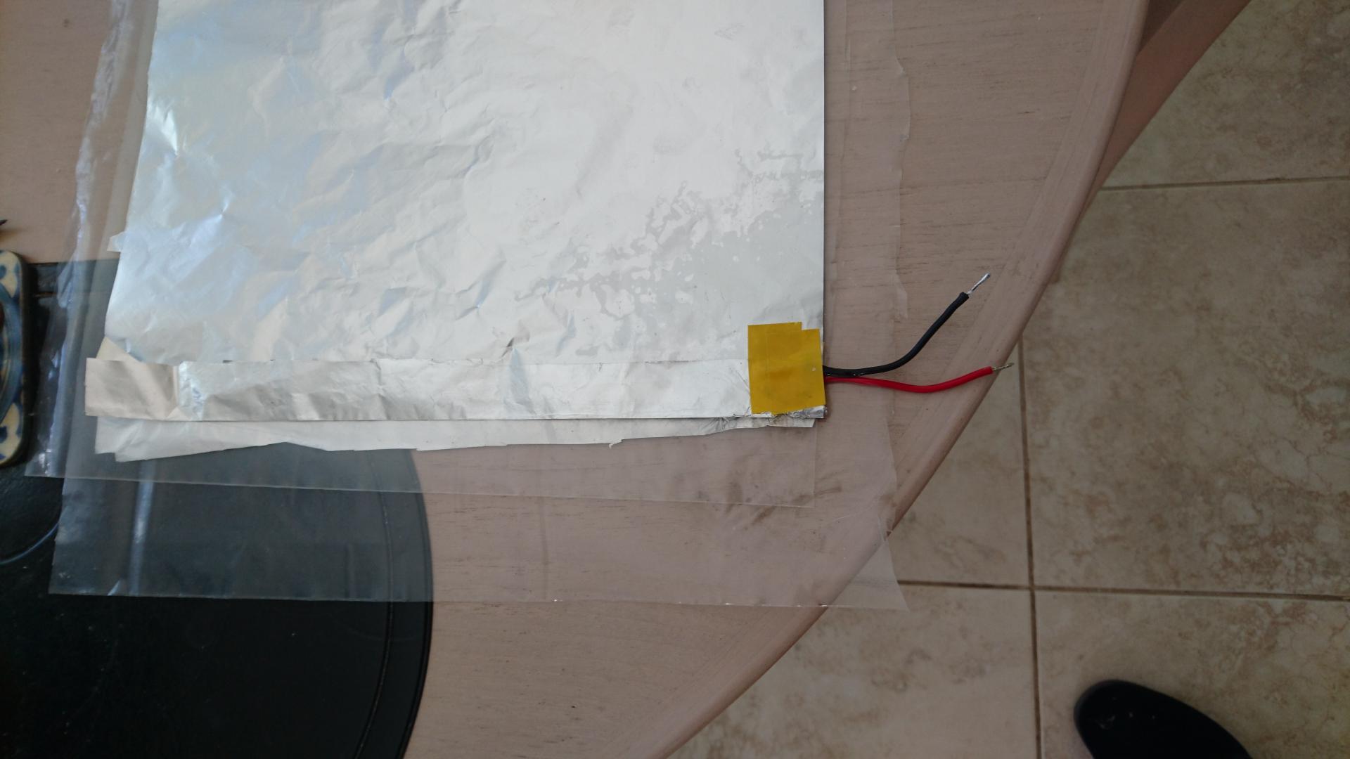

                            this is something gladdening if my analyse is correct i suggest using another thick aluminium foils the same as the proposed video about How to Solder copper wire to aluminum foil,if it's the same Super Strong" kitchen foil please solder it using any mineral oil, sometimes Olive oil do the job !!! you have 4 connections if anyone fail or work partially the system don't work good , this is the first note.
                            when the ETBC run in this arrangement it also receive radiant energy from the tower coil which go back to the MOSFET make them run hot, the foils are a good antenna so they will receive a good amount of power , don't worry about this because i noticed this too but the most important is you have successfully replicate one of the famous Tesla experiment, this circuit is also important in high voltage because it's easy to maintain the resonance of ETBC when we take the power from it, also we don't worry too much about the radiant feedback that make the MOSFET run hot ..

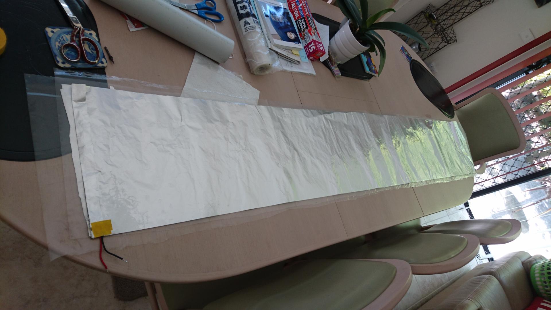

                            • 2nd test
                              Hi med,
                              Just to be clear, going through the thread, the aluminium strips used backed with packaging tape are being wound onto a TV wire wound yoke? My recollection of yokes is they did not have ferrite cores but were wound straight onto the neck of the tube. just looking to see if I under stand positional effects!!
                              Dwane
                              • 2nd test_a
                                Going to be a little while before I am able to garner the parts. To get the copper foil, it has to be posted. Wrong time of the year for speedy postal services. Maybe a week.
