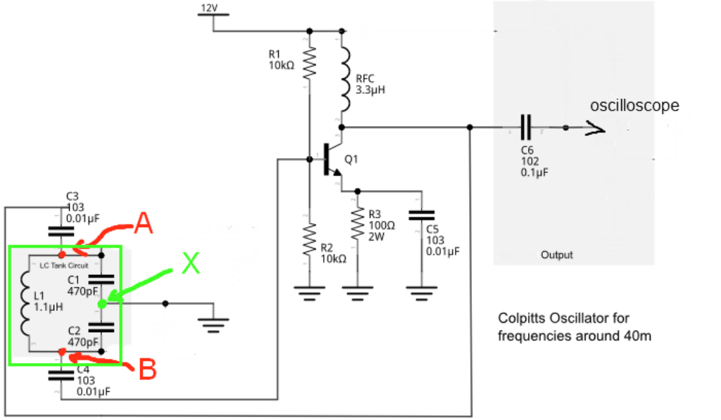

      to measure the resonance frequency of the E-TBC there is a need for frequency generator plus an oscilloscope, but if a frequency generator is absent there exist a way to do this without frequency generator,
      just build the following simple Colpitts oscillator which in turn based on LC tank circuit, close C D connections in your E-TBC, connect it as shown from A B and X point ( x = CD closed ).
      i tried this circuit with two different E-TBC and it gave a nice result showing the frequency of 3.2 MHZ and 1.4 MHZ , the objective is to achieve a manageable frequency up to 17 MHZ so the quarter wave length will be

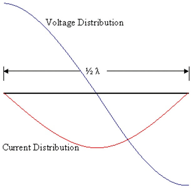

      143/ 2x frequency in MHZ if f=17 MHZ the quarter wave will be = 143/2x17 = 4.2 meter .
      4.2 meter will be the length used to wind our L2 coil, it's important to wind it with space between adjacent turn. more space is needed in the edge of the twin coils due to the fact that the voltage has a maximum value in these two points, doing so will avoid the interference between points with higher voltage and the rest of the coil, this help the wave to see the length of wire instead of seeing the length of the coil .

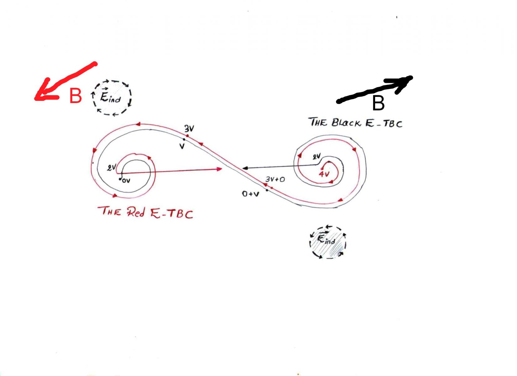

        i said before that the dual extended Tesla Bi-filar coil work as two separated E-TBC connected together in reversed mode but i think it's a mistake to see the Dual E-TBC as two separated E-TBC.
        the Dual E-TBC is another derivative of a single E-TBC, it has two coils and two capacitors, the coils are linked electrically and the capacitors are linked magnetically, because cold electricity is absent in the dual E-TBC this mean the black E-TBC work in opposite manner compared to the red E-TBC and due to the fact the coil will transform into capacitor in the negative energy sea and the same happen to the capacitor when it transform into coil in negative energy perspective.
        from energetic perspective the coil in the RED E-TBC have to pass through the center virtual capacitor to reach the other coil side situated in the Black E-TBC and the same will happen to the two capacitors in each side where they are connected magnetically in the center of the dual E-TBC because each virtual coils must be compressed before reaching the real capacitors, the capacitors and the coils in this model are energetic elements ... they can't be seeing.
        we need practical measurement to see if this model is correct or no, if it's correct the resonance frequency of the dual E-TBC have to be the same as a single E-TBC!
        the internal capacitor in a single E-TBC jump to four time less C/4 when oscillating but in the dual E-TBC the coil come to play too and it will jump to the half L/2 .
        another player in this design is the induced electric field which double the gained power compared to a single E-TBC where each adjacent plates receive twice the voltage which in turn double the the received ambient electrons, in other hand the received electrons in each side isn't similar because each coil work as the back EMF for the other side which bring the current and the voltage in the same design with radio frequency speed.
        the above information is a point of view and it need confirmation.

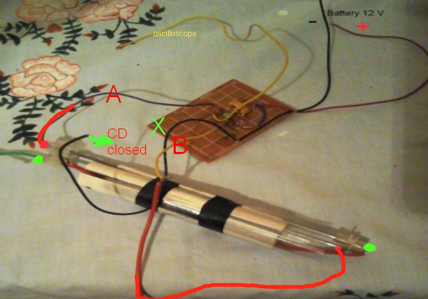

            the circuit is very easy, i built it in a hole test board , the green frame will be removed and instead of it just connect your E-TBC as shown, the transistor i used is extinct it's 2N1711 you can look for it equivalent, or try another transistor suitable for oscillation purpose Google for it.
            the test equipment is a PC based oscilloscope the famous Hantek 6022BE, it's a very cheap and capable of working around 20MHZ which is the speed i am looking for.

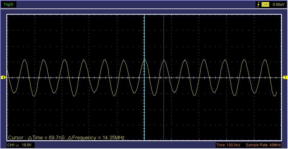

            the following image show the oscillation graph from an E-TBC built using aluminum foil with 5cm width and 16.5cm length wound on 2cm plastic tube diameter and it gave 14.35 MHZ which is a good frequency since we are able to work on increasing the insulator thickness to achieve higher frequency around 20MHZ which in turn a manageable frequency.
            any further questions are welcome.

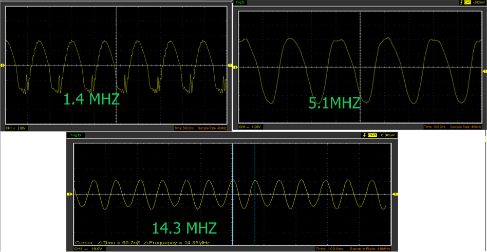

              The improved oscillation in high frequency region using the E-TBC in Colpitts design
              just to share the oscillation graphs through 3 frequency regions using the E-TBC in Colpitts design.

                          notice the words radiated and wasted, the inventor was talking about the induced electric field, i analyzed this phenomena in my presentation and i said why the E-TBC is able to conserve this wasted field.
                          it's my perspective how i see things... is it true or false is a mere question of time ...

                              You mentioned that you tried this circuit with two different E-TBC and it gave a nice result showing the frequency of 3.2 MHZ and 1.4 MHZ. One operated at a frequency of 3.2 MHz and the other at 1.4 MHz, correct?
                              Can you please post dimensions, materials, circuit diagram and detail the connections to your test equipment? Other measurements that would be helpful to confirm your observations would also be appreciated.
                              Thank you.
                              This is the circuit used for testing the resonance frequency, all the electronic parts from old equipment.
