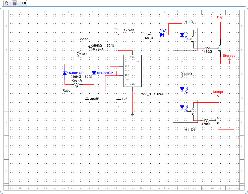

    This is a shunt regulator which could be re-purposed as a cap dump circuit. Generally used to dump energy without allowing a load ( like a wind turbine ) to run free - always loaded. I've built a few of these long ago and they work exceptionally well.
    Thank you very much Dragon for this circuit!
    So as i see it the input is on the left side (where the bat is) and the output is on the right side (where the 250w resistor is)... Is this correct?

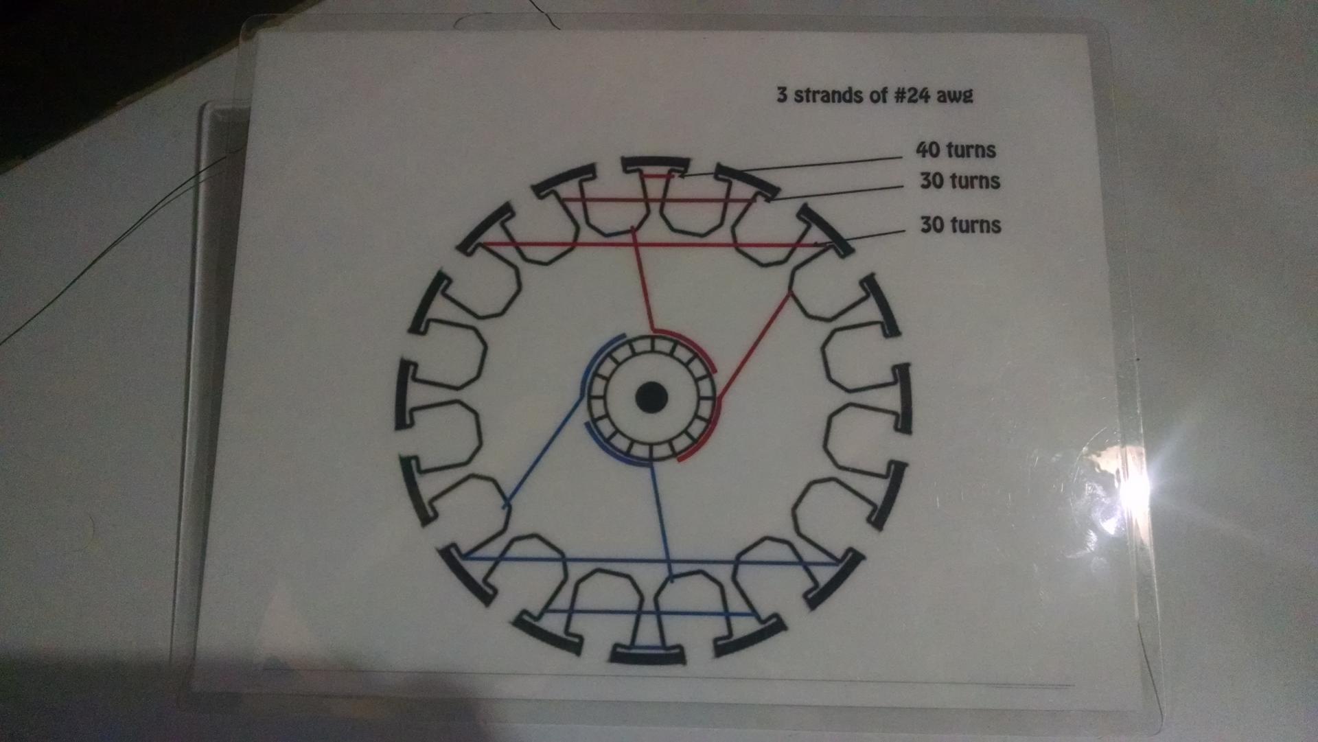

                Matt, I'm winding one of your Razor Scooter modifications using the attached drawing. It says, "3 strands of 24 AWG". Is that 3 strands per turn (the 40 turns has 3 strands, the 30 turns has 3 strands) or is it one strand of 40 turns, then one strand of 30 turns, and one strand of 30 turns?

                  Its just 3 strands all the time. I think the total was 100 turns.
