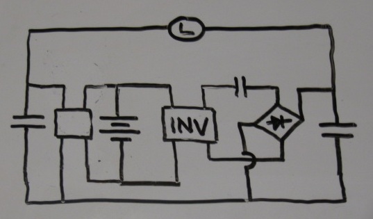

    Driving the inverter directly from the battery, rectifying the output to charge a cap... drive a load from the HV DC to charge another cap, buck that energy back down to the battery. It worked very well right up until the charging cap went over 40 volts and the buck "bucked"...
    My original test with this set up used a 10 watt LED bulb, the non dimmable type with an internal switching circuit. Once the charge cap reached 55 volts the bulb would fire directly into the battery - all the neg's were common(battery, inverter and both HV caps) where the one shown isolates the battery circuit, the bulb simply bridged the charge cap to the battery pos. This was quite interesting because I ran a 10 watt load to control charge to the cap and a 10 watt load to pulse the battery, the watt meter never rose above 10 watts. The charge back bulb would run for 30 seconds at a time depleting the charge turn off then back on .
    The second load didn't cost anything to drive it and charge the battery. A very interesting build. I'd like to work toward maintaining both caps at a level where the potential differences remain fairly stable. This puts the inverter into a low power idle then run only the load on the battery charge side. We'll see where it ends up I guess...
    .Food for thought if nothing else...
    • The above diagram appears to work reasonably well although I haven't been able to test the overall charging to the battery. It would appear to require a stable balancing of what the inverter is outputting and the draw on the second cap to return the charge to the battery.
      An MPPT charge controller in place of the buck would give the overall control needed to maintain a balance. The controller tracks maximum power and adjusts it's output determined by it's input. I found one that was inexpensive enough to give it a shot and has a maximum of 100 volt input which shouldn't cause any problems.

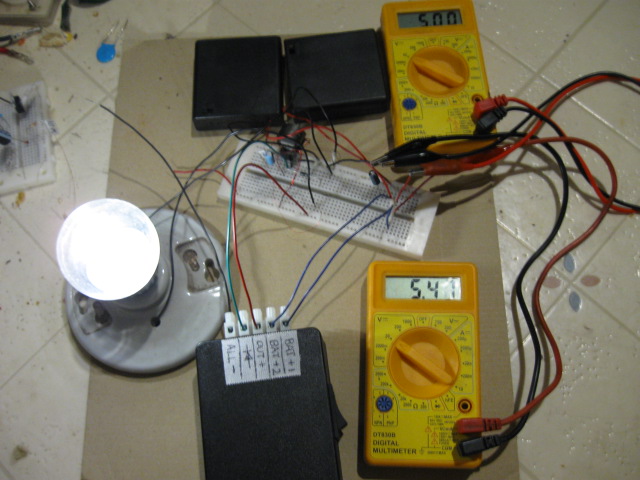

          While waiting for the MPPT, a past project has been resurrected. To be honest it was never thought to be anything more than a novelty for extending the run time of JT circuits. It appears I was being a bit short sited...
          Over the last couple days it's shown me that it might be possible to bring it up into a power level that would provide a useful output, although, as the output power goes up so do the challenges. However, it does meet the criteria of my end goal.

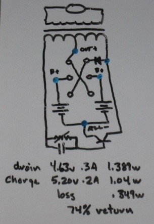

          The picture shows a small Hartley circuit driving a 120v 3watt LED bulb utilizing a switch circuit to drain one bank and charge the next - when one bank is charged it can be switched back to reverse the process. I had never done any real measuring of the circuit - simply running it for days on end to see how long it would last...
          To my surprise it was returning 74% of the energy... really close to my 80% acceptable range. So to put that into perspective if you were running a 10ah load, 7.5 ah is being returned, effectively running a 10 amp load with only a 2.5 amp loss. So I'm thinking if I can simply toss a project like this together with little thought with this much return I should be able to surpass the 80% with a little thought.
          The circuit diagram is one that I've shared over the years, most recently in Mikey's thread, so once again I'll bring it to light with a little different perspective...
          It also lines up with the thoughts that both batteries should be the same capacity and voltage where the difference in potential is relatively low for the highest efficiency in transferring energy between the batteries. There are a few flaws with it as is but the basics are all there....

                • Hi all, thanks dragon for sharing.
                  I did save the pic you posted previously on mikeys, splitting the positive thread and that one showed the wiring of the switches better.
                  It looks like you are using three, 3 way switches or three, double pole-double throw switches.
                  Normally, when i have tried to use a secondary to power a load and also extract the flyback from primary coil of joule thief, the output of secondary was cut off or not much output resulted.
                  I wonder if because you are using the boost converter configuration of oscillator, that may be the reason you are getting also good secondary output.
                  Anyway, i will try this setup at some point.
                  Oh, still waiting for my boost converter.
                  peace love light
                  Edit: Dragon, can you share what coil turns ratio you used, primary to secondary, thanks

                    The diagram shows the pin outs on the DPDT switch ( just one switch ). A basic on-off-on type switch.
                    Generally when people try to use the forward momentum (flyback, EMF etc) on this type of circuit they don't provide a complete path through the circuit. If you notice both batteries and coil with the diode form a completed circuit for the current to flow. It's basically the same as a simple boost converter.
                    The hartley circuit was wound on one of those tiny enclosed cores, I think I purchased them from nebraska surplus. This was built a few years back for low power lighting, unfortunately, I don't know the exact turns, I put one layer of 26 wire on the bobbin, created a center tap there and finished off the second layer for the primary. I filled the bobbin with 32 wire for the secondary.
