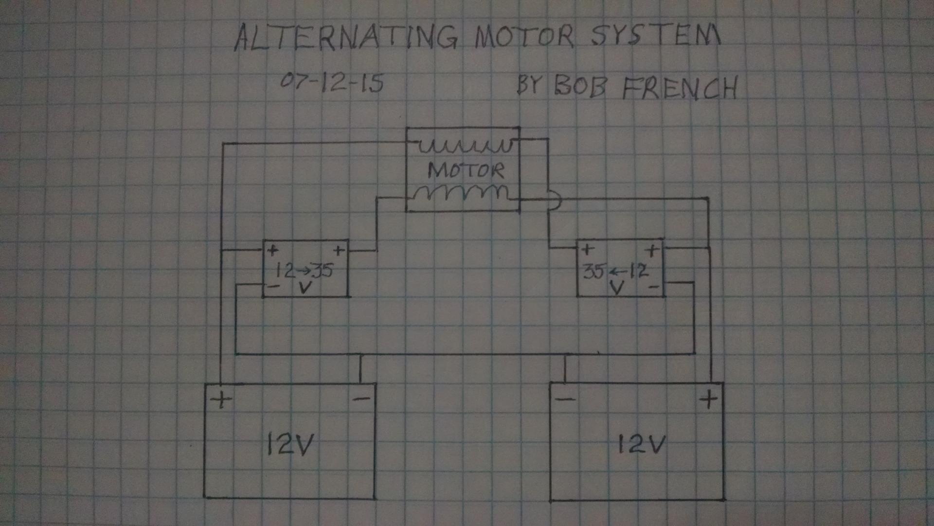

                            Right now I've been working with my two battery system and I'm pleased so far. My plan is to replace the switching with a pulse motor that has two inputs and alternates between two outputs (input from B1's Boost Module goes though motor and outputs to B2; input from B2's Boost Module goes though motor and outputs to B1). When the commutator switches to one side, it disconnects from the other, and visa versa. It does the same thing as the Arduino plus gives added opportunity to make more power.
                            We'll see.

                            • Alternating Boost Charging
                              Here's a drawing of the Alternating Motor System.
                              • Hi Bob,
                                That is a good idea of using the motor to do the switching. That might be an easy way to switch charge from one side to the other. I have a couple of scooter motors I have been rewinding in different ways to see what they would do so I might give that idea a try also.
