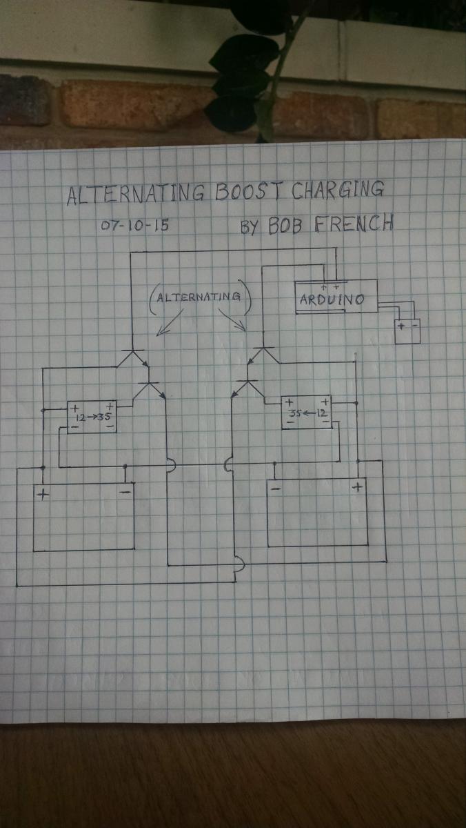

        • Alternating Boost Charging
          Hi guys,
          Starting with this post I am using the circuit shown below. The batteries are LA and are labeled B1 and B2 and are never swapped. The charge is being sent back and forth.
          I'm trying to do this on my phone...we'll see if it works. Here's a circuit that alternates the charging from one side to the other, back and forth. There doesn't seem to be any conflicting paths.
          Also I bought a battery analyzer like Dave's (about $70). I think we need to track CCA as well as voltage. I haven't been able to verify it, but it seems to me that if we effect a battery so as to desulfate or increase its capacity, then the energy in the battery will "spread out" and show a lower voltage. Perhaps someone can chime in on that point.
          I ran an hour long test last night with the circuit and measured it this morning...broke even, exactly even. I ran another this afternoon and will measure results when I return home in a few more hours. I am using Carroll's 15ms dump and 60ms cap filling, by going high for 15ms then low for 22ms on each side.
          I forgot to note that the Arduino is running off its own separate third battery.
          Bob
          Last edited by bobfrench@fastmail.fm; 07-14-2015, 11:49 AM. Reason: To bring conformity
            Here's a better pic.
            BTW, I may not comment on everyone's posts, but I read them all and appreciate your work. By and by we will come up with something.
            Bob

              • Originally posted by bobfrench@fastmail.fm View Post
                Hi guys,
                Bob
                Hi Bob, that looks like a good simple way to do something very similar to the tesla switch approach, but you don't show any load in the charge lines to limit current and drop the voltage. You probably already know this well, but high voltage pulses at higher level current could potentially cause a lead acid battery to explode, so be careful. You may find that lower voltage pulses such as 15 or 16 volts or thereabouts may work just as well with less risk. Not sure what are considered 'safe' peak voltages on pulses to use with lead acid batteries... Anyone know? Yes, as was already discussed, just measuring the open circuit rest voltage on batteries doesn't tell you much about their actual charge level. The open circuit terminal voltage can be quite misleading.
                level
