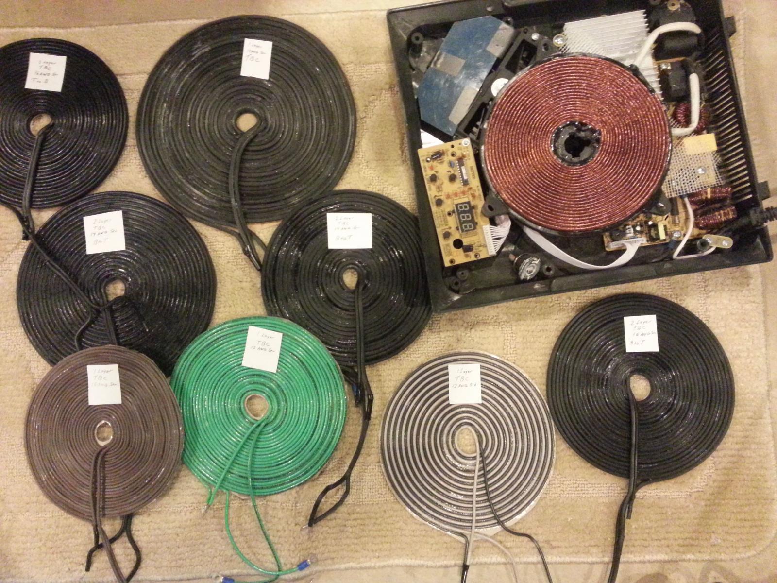

    Lol, Guess I had tried a few more different combination than I remembered. Sleep deprivation does not make for a good memory. Here is a picture of the coils I tried and the cooker I used. BTW, it still works!
    Randy

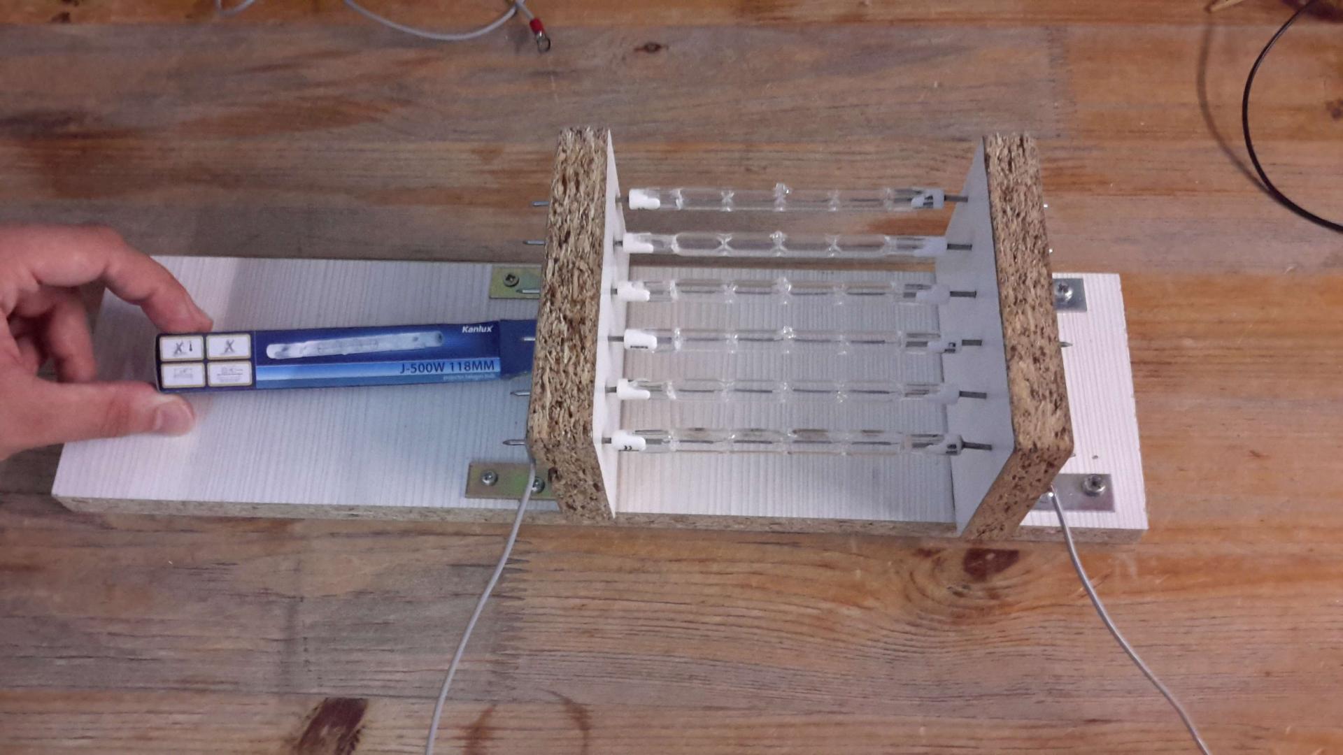

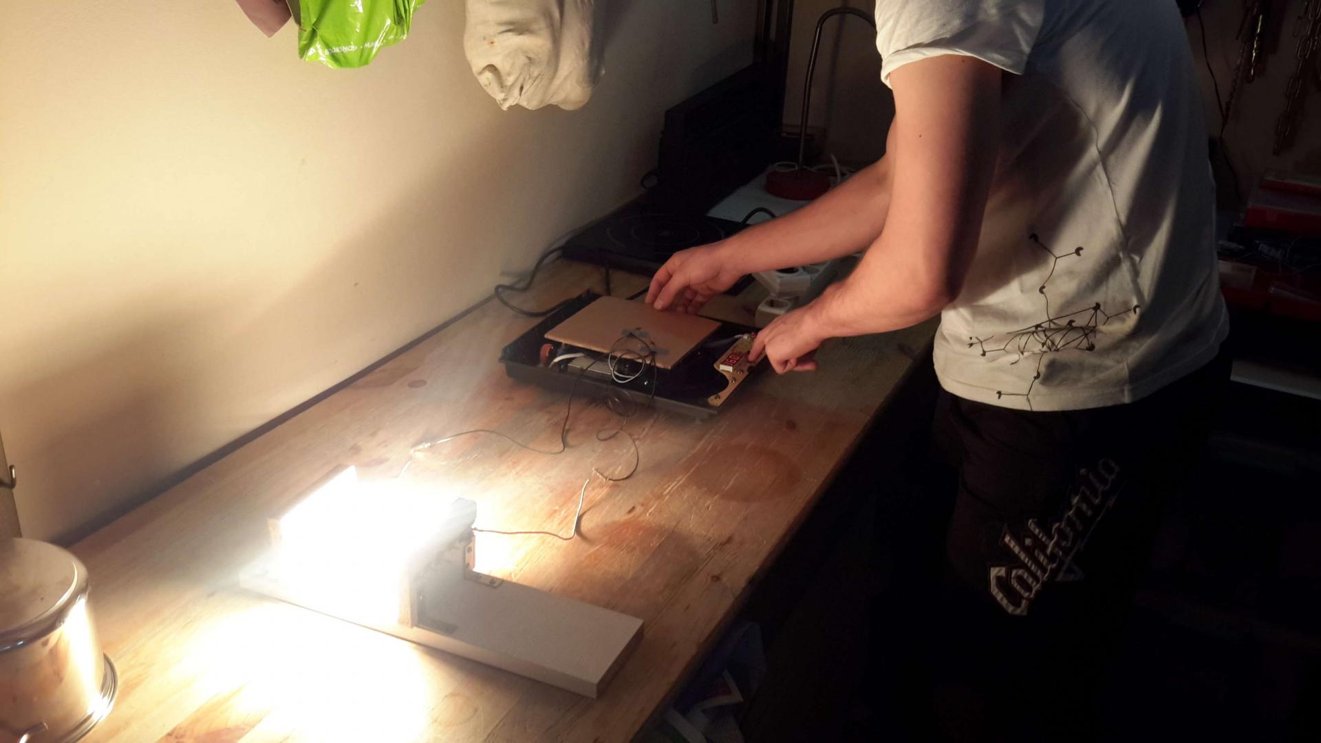

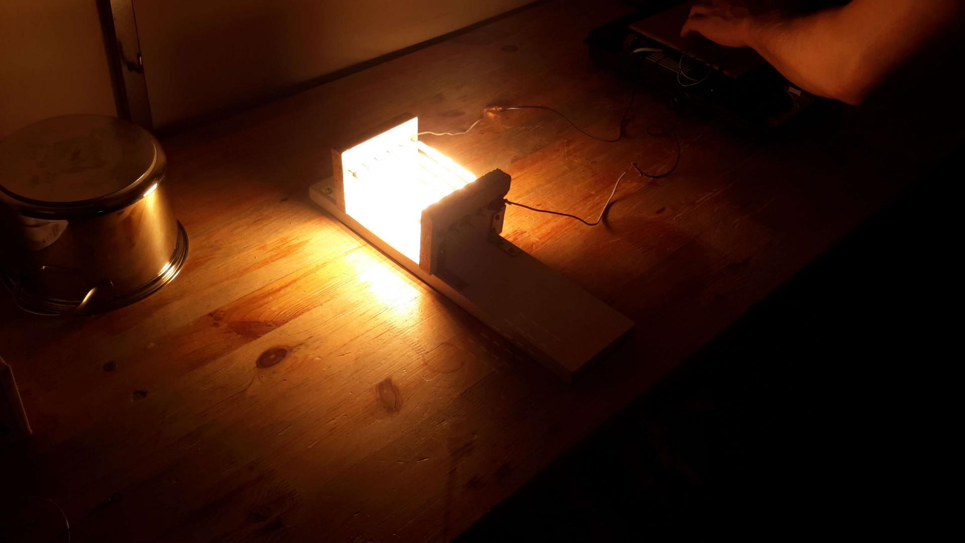

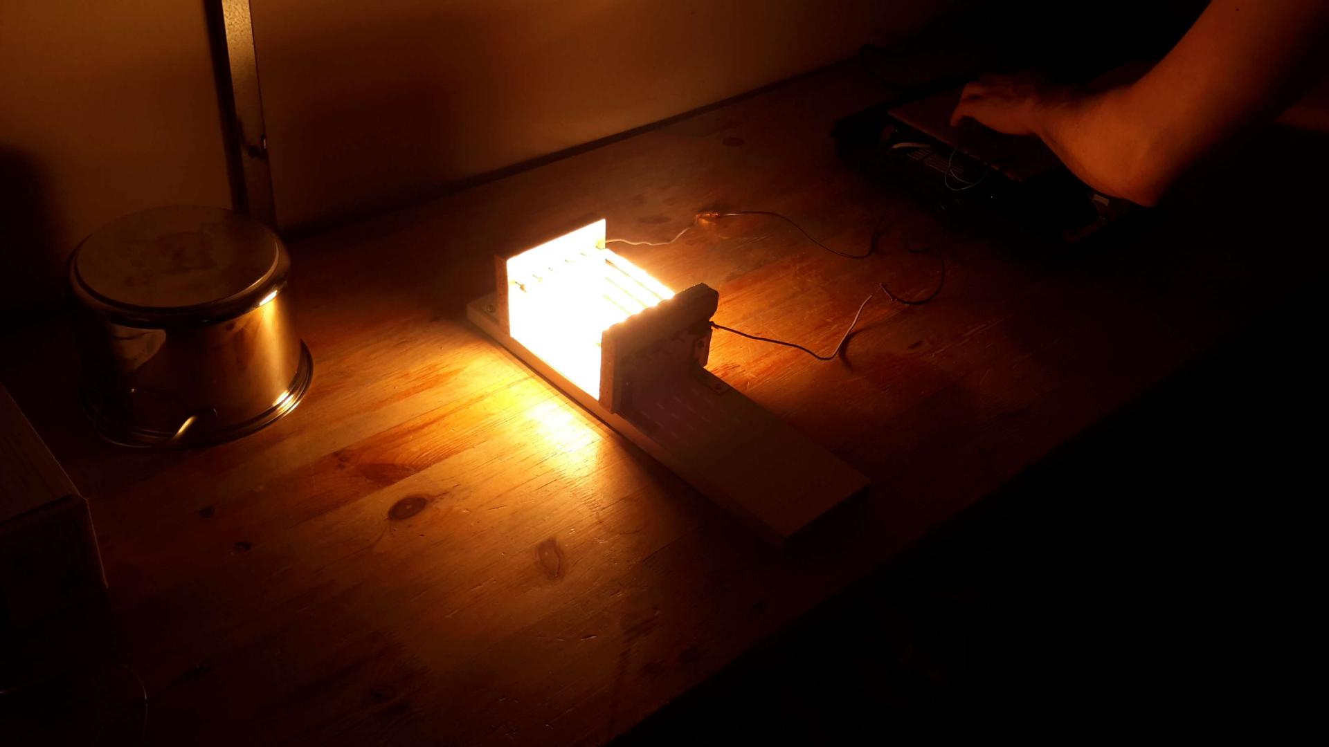

            • GEGENE replication
              I used a Tarrington House IC2009 induction cooker, 2x75mm2 speaker wire for the TBC which was around 12 turns (double) and ~13.5cm in diameter, slightly smaller than the induction coil which was ~14.5. Used a watt meter to check power consumption from the grid, which was in sensible agreement (~20w deviations). The load was 6x500w halogen bulbs connected in parallel.
              Interesting was that when increasing the power from 1600 to 1800w, I could barely see an increase in brightness, while from 1800 to 2000w (max) there seemed to be no increase at all. If correct, this would mean that the 3000w load was maxed out somewhere between 1600 and 1800w. Below 1600w the brightness increased according to the wattage increment. These are just my 2 cents to the thread - I will be aiming to get a scope and do some proper measurements. JLN's electrical kettle test (which is quite a precise way to measure power consumption) does create a discrepancy with many other results which show COP>1.
