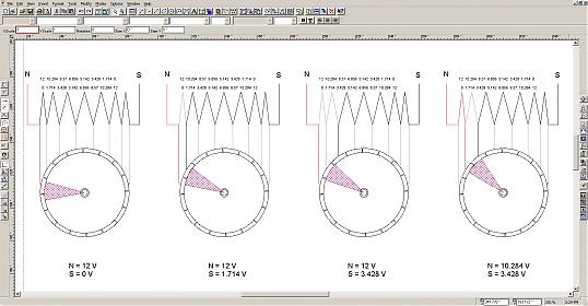

Hi CadmanOriginally posted by Cadman View PostAs this drawing shows, the only magnetic collapse is from 1.714 V to 0 V (based on evenly split 12VDC).
In this link to a previous post you can download a simulation in Excel of the commutator. As you can see the voltage never drops to 0 V because always there is a part of the current reaching the farest electromagnet.
