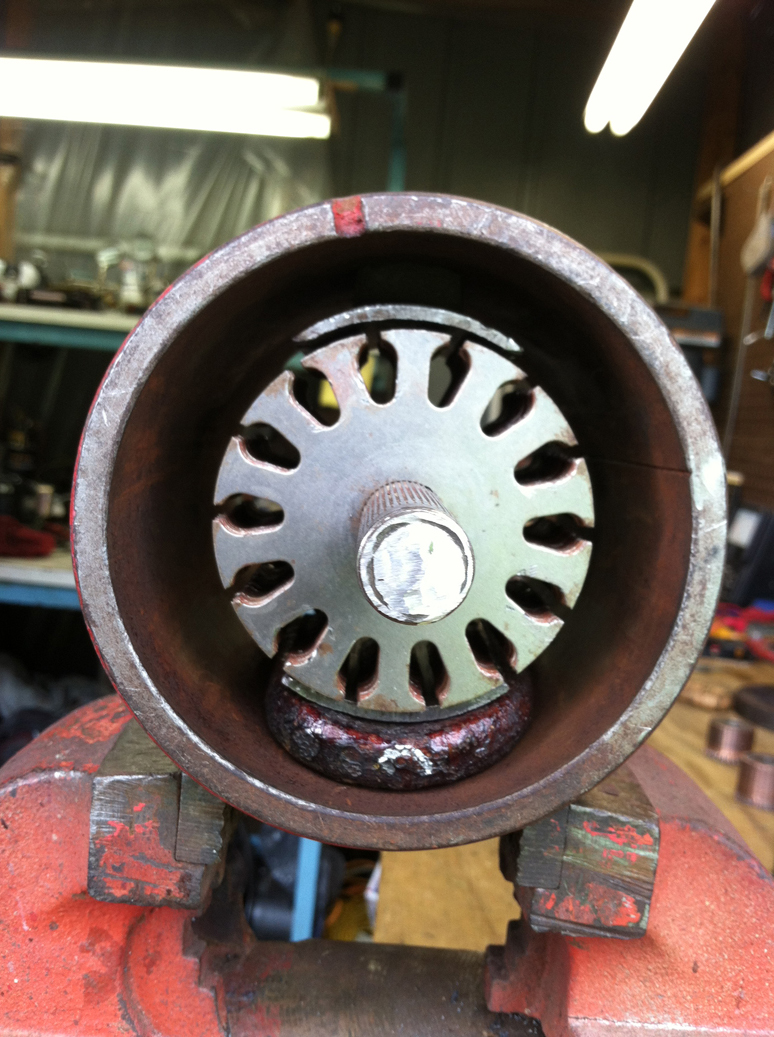

                          • Hey UFOpolitics, this is all I have for right now. I'm still getting parts and cleaning it. If you need more than this let me know but it'll take me a few days.
                            Thanks again,
                            wantomake

                            • According to picture...
                              Thanks again,
                              wantomake
                              [ATTACH]14687[/ATTACH]
                              Hello Wantomake,
                              According to that picture every Stator comprehends Three(3) Poles...great!
                              I just need to know:
                              Did you removed the other Two(2) Stators on the housing?
                              Or is it just two Stators?
                              I could not see holes to bolt down stators core on the missing side (horizontal).
                              Also, it looks like a pretty heavy rotor core...thicker poles on the "T" vertical side represents less space for copper, as not too deep notch cut towards shaft either.
                              Still you could try winding it and see what it does when it is all finished.
                              On the wound stators, please, before removing wire by cutting it and trashing it out...try to write down the spec's, as number of turns and wire gauge.
                              Ufopolitics
