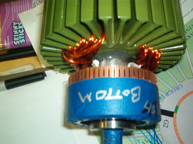

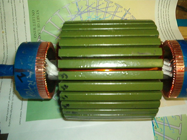

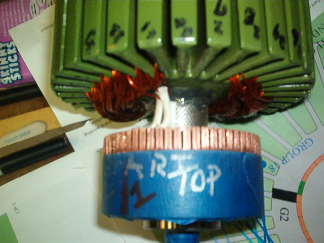

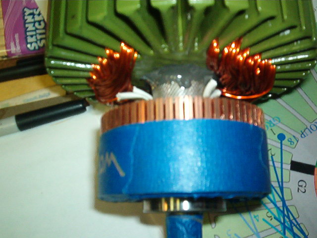

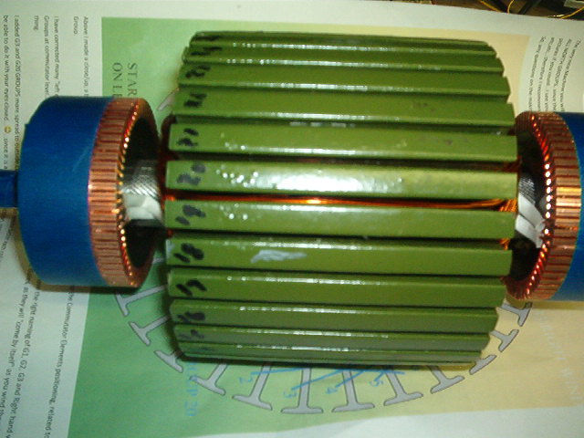

    I have started winding my armature for the P66 motor.
    First crack out of the box, I wound four strands then noticed the commutator had twice the number of segments as the rotor has slots. That means skipping one segment between winds instead of starting the wind 'next to' the one just completed.
    Had to fix that.
    Then, I looked at Mr. UFOPolitics' drawing and recommendations again....
    Oooopppsss, I was winding only on one side. So, stopped that and started on the opposite side to keep things balanced.
    Its coming along nicely now.
    Each coil gets 7 turns of #18 gauge wire. Each group consists of 6 coils for a total of 42 turns of wire. This may be one turn too many, but it is easier to make the coils shorter than longer......
    Pics are here: P66 Motor Wind Photos by GlenWV | Photobucket
    Comments and suggestions are welcome.

          Hello Glen,
          I was waiting for your update!...it is great to hear again from you
          Yes, your Motor is a 33 Poles/ 66 Commutator Elements, same as P56 is a 28 Poles/56 Comm Elements.
          You DON'T jump each one of the Elements...leaving one not connected!...but, instead, you JOIN each Two Elements and attach Two to each Group wire, upper and bottom...that way we have a continuous contact On at all times.
          Take a look at this Video...will give you many hints on the start.
          I use a 16 gauge piece of "U" wire to make that fastening and to join each two elements together.
          [IMG][/IMG]
          It is VERY IMPORTANT that you assign the correct Two Commutator Elements for each Group!!.
          For example, and as a MAIN GUIDE, look at Group 1 above on Left...and notice the corresponding Two Commutator Elements that are in RED(Red for positive Input Upper, as connecting shaft is pointing towards you, out of screen)...So, note that those Two Elements are EXACTLY at the end of Coil #6 LAST POLE...of Group 1
          Now looking at your Stators positioning and Rotor, again, looking at Group 1 and Comm Elements in Red:
          [IMG][/IMG]
          Note Brush "M1" is JUST STARTING to make contact with the two elements that belong to G1...Then look at N1 and S1 Stators positioning related to G1...That is exactly when G1 should start getting fired/energized, according to Rotation R....And G2-which is ahead of G1- is "leaving contact" with Brush M1.

          Seven (7) turns per each coil is great!...Just make sure you will have enough room at each slot for other Group-Coils that will overlap/cross that slot.
          You will be fine with just 5-6 turns per coil, just in case you need to reduce to lesser turns.
          Thanks for sharing your work!

                          • P66 Update
                            Greetings all:
                            I 'get it' when it comes to connecting the adjacent node on the commutator. That was being done when I noticed multiple segments were reading very low ohms. (dead short!)
                            When the machine shop guy installed the commutators, he trued them up. In doing so, some of the commutator segments were shorted by small fragments of copper in the slots between segments. On a few of the segments, near where the wires go into the slots, the copper was actually drawn across the void to the next segment.
                            Took a bit, but I fixed that last night.
                            I removed the windings, as 7 turns looked to be a bit much as the thing progressed.... (Mr. UFOPolitics said as much!) So, I'll start over using 5 turns per coil. (My point in starting with 7 turns was to stuff as much wire into the thing as it would hold.)
                            Winding coils is an art, so a little more practice will end up giving me a better product in the end.
                            glen

                              • Cleaning Commutators...
                                Originally posted by GlenWV View Post
                                Greetings all:
                                glen
                                @Mikey: Mike, I want this motor running at constant speed and will use it to spin a generator. The idea is to grab some power from the generator, rectify it, and use it to power the motor. Loop-di-doooo (with switching)
                                Hello Glen,
                                Yeah, I figured 7 turns were too many...Five would be fine...
                                Related to Commutator metal debris cleaning...If you have access to an air compressor and a hand regulated blower ...going into each of the segments gaps would be the best way...
                                Make sure to wear Eye Goggles and a Dust Mask.
                                Ufopolitics
