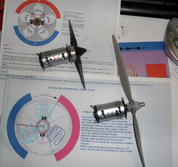

                  • hi all
                    just going on my apprentice schooling
                    and here a pix of my 3 poles modified "Igarashi motor"
                    it works really well
                    The winding is 3 X 100 turns with 0.2 mm copper wire , the same as per my 5 pole replication
                    the torque is really strong and the generator is quite high.
                    i know that all this is subjectiv but it is my feeling so far
                    for more measured resutls , please be patient, or much better replicate and give us details
                    always at full enthusiasm on this project
                    good luck at all
                    Laurent
