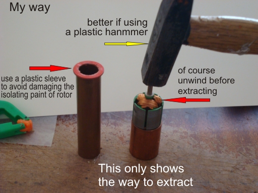

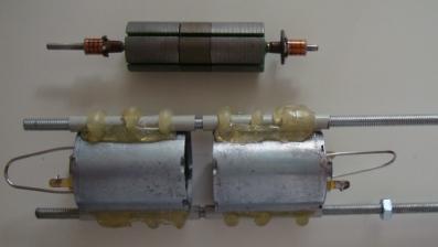

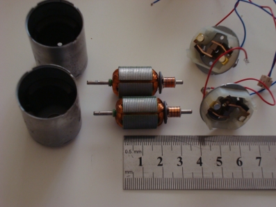

                        • Hola Alvaro
                          I like what you're building! I have a lot of this motors, so how did you joined the armatures? You taken out the shaft of the small armature (in the pic the one in the middle) and put inside the shafts of the other two? If so, how did you taken out the shaft? because it seem to be very tight! I do not want to break it
                          And by the way... I guess nobody here be upset you being posting here!
                          Un abrazo!
                          Nico
                          • Originally posted by nico8k View Post
                            Hola Alvaro
                            Un abrazo!
                            Nico
                            • Nico
                              here you are, made the pic asap
                              regards
                              Alvaro
                              forgot to say: there is a tiny bronze sleeve after and before commutator. peel it,remove it before removing shaft. I insert a plier between it & rotor, fix plier and hammer shaft.

                              • Originally posted by interdesign21 View Post
                                OR have I to use a wider one ? (Got a lot of SWG 28 = 0.37mm) OR
                                Hola Alvaro,
                                I was "Cacharreando" since this site is still collapsingCacharreo • Ver foro - Energia Libre - Free Energy
                                Back at Interdesign:It will NEVER upset Me any material displayed here related to Replications...AT ALL!!
                                So be very Welcome!
                                Now:
                                1-To Enhance the Generator side use the Dual Pentagons...use the higher awg possible...30 if you could or even 26...(28 IS JUST PERFECTO!!) and try as much wire as you could turn there as long as ALL are the same number of turns...
                                Remember that the Dual Penta is a very Asymmetric Core distributed design...all Souths Coils are wound in just ONE POLE...as all Norths are wound comprehending TWO POLES...so you MUST compensate the "Magnetic Weights" on both Coils by using LENGTH of Wire and NOT TURNS!!
                                2- Is great you have increased the length of the armature core AWESOME!!!...I see you have learned the lesson very well!!...
                                You are going to get a heck of a Generator there...I am sure of it!!
                                NOW for the Motor to turn that Generator you will need a strong Machine!!
                                If You have already wound the other motor with the Radio Shack Five Pole Design...is perfect...BUT you should try to add finer wire there...and less turns to balance Amps draw...but still have good torque...
                                The Five Poles is a faster Motor than the Dual Penta...and have great torque...so it will work fine.
