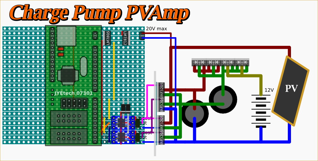

Hi all,
I bring stuff and thoughts for all:
1. NOTE: i make errors, check my circuits and check principles against plain common sense? It is possible that i wire up a sketch that has errors in it?
2. I plan to make a 60A variant in MJL before I switch entirely to IRF and 200A
3. The brains are halfway there already (a ATmega48 based Quer from JYETech (namely 07301) (<-Google it out))
4. It will hopefully be a new version of a howto when ready
5. I hope we all make progress here not pointless arguments (please be patient an as polite as practical?)

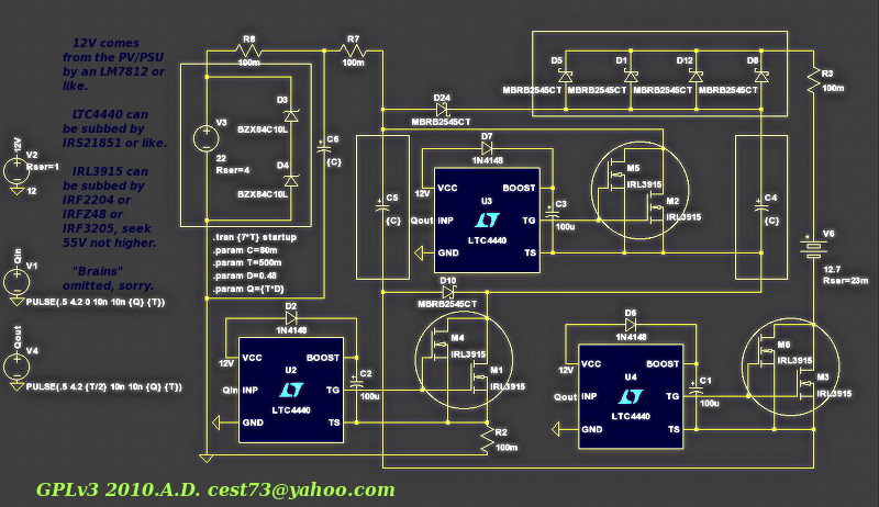

1. @SeaMonkey, I run tests in SPICE already regarding Your charge pumps (CP)
no spikes? maybe negative ones (=bad for battery)? how come?
2. The TS PV AMP has accented unidirectional kicks that are absent in the CP You posted.

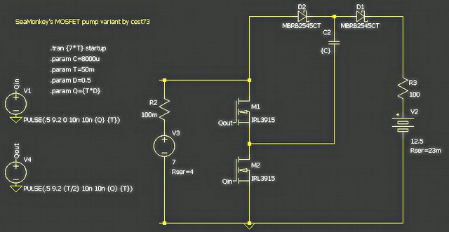

3. I re-arranged the components in the drawing You posted, hope You don't mind i re-posted it here, so we (layman) see the process better?
4. The rest are the circuits I'm currently "planning about"
The MOSFET and BJT versions checked in SPICE (no hardware yet)...
5. comments:

That charge pump circuit SeaMonkey posted is straight out of the document above ( IXAN0009.pdf ) that Bits-n-Bytes posted. This is a bit over my head so I have to ask what is the significance of this charge pump and how can it be useful?There is no important work, there are only a series of moments to demonstrate your mastery and impeccability. Quote from Almine
I have redrawn that circuit and it is a normal ac to dc voltage doubler with the big difference that it is pulsed dc of 400Khz on the input with sharp rise and fall times instead of 50Hz ac.
I think I will try this one sometime to see the effect on a battery.Last edited by nvisser; 08-27-2010, 06:32 PM.

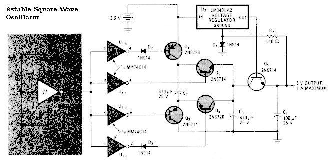

Here's a very old circuit from a magazine article yearsOriginally posted by Matthew Jones View PostJust out a curiosity...
What about stepping down voltage. Is there anything like that that can step down voltage just with switching no inductor's? Maybe retain some amperage.
I don't want use a voltage divider. Resistance makes heat and capacitors don't allow the amperage to flow well.
Just a side thought.
Matt
ago. It didn't scan with a great deal of clarity but by
checking the transistor types you'll be able to determine
which are NPN and which are PNP.
It would be possible to upgrade this circuit with MosFets
for increased efficiency and greater output current.
The voltage regulator as used in this circuit is optional.Last edited by SeaMonkey; 11-05-2010, 10:56 PM.

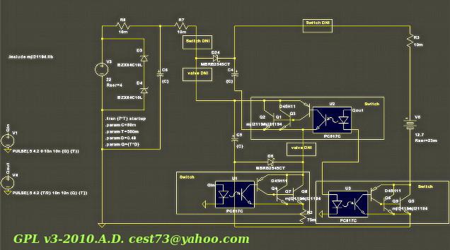

Ah,
circuit design pictures galore continued: (a collectible graphic series "as seen on TV"
