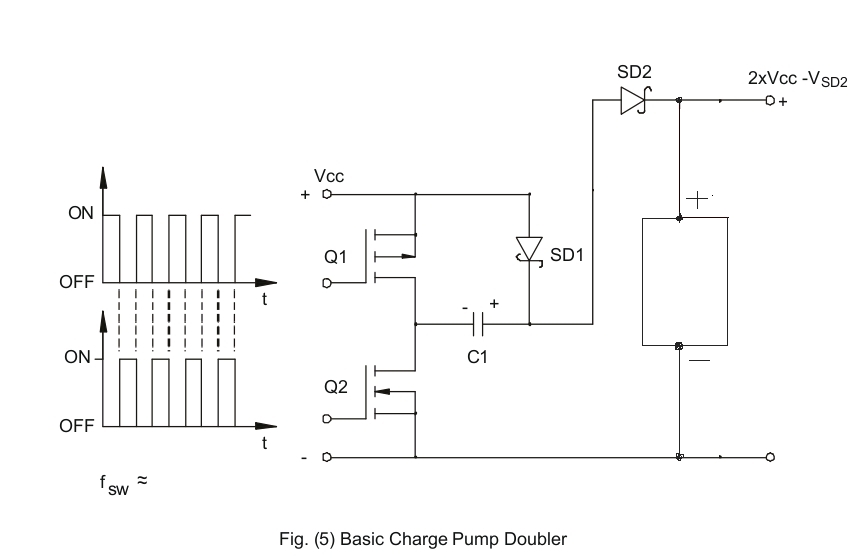

                          • Food for Thought
                            Originally posted by nvisser
                            Like this. I cannot see it.
                            Nor can I.
                            The switches are correctly positioned to put the
                            LEFT BANK in series to power the load;
                            The RIGHT BANK in parallel to receive 'load current'
                            as Charge Current;
                            LEFT BANK (minus) RIGHT BANK (equals) 12 Volts across Load
                            But, check the diodes at Batt 3 and Batt 4. Are
                            they positioned properly to permit Load Current
                            and Charge Current?
                            Wouldn't it work best if the diodes were REVERSED from
                            the way they're shown?
                            Hint:
                            As shown the diodes will block current flow in the entire
                            circuit.
                            Also, for Stevan and others who are working on the
                            Charge Pump circuit (PV):
                            See second thumbnail Basi[c] Charge Pump Doubler
                            FOOD FOR THOUGHT.
                            Can you figure out how it works?
                            Could you put the principle to use?
                              FOOD FOR THOUGHT.
                              There is some detailed info in the attached document on the second thumbnail and credit to the authors
                              HOW TO DRIVE MOSFETs AND IGBTs INTO
                              THE 21ST CENTURY
                              By
                              Mr. Abhijit D. Pathak and Mr. Ralph E. Locher,
                              IXYS Corporation
                              Santa Clara, CA 95054
                              Jeff

                                Simplified Battery Pulsing Circuit in thumbnail.
