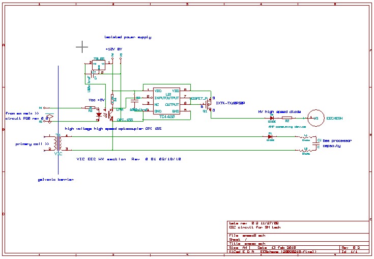

    thank you, now I can really handle KiCad thanks to your valuable tips
    @all
    there is an outstanding task for integration of frequency to voltage conversion as substitute for SM fig. 4. Point "J" seems to be a variable frequency source that has to be changed to linear voltage between 0V and Vbatt.

    • Hi Bussi,
      I think that just might work
      Just to make sure everyone is on the same page with concern to just what engine management sensors we need. For proper engine management we will need sensors that control genaral idle function and sensors for torque sensing. These sensors control the voltage amplitude our voltage zones will have. Genaral function sensors are like throtle position, mass air flow, rpm guage voltages, and the like. Torque sensors can be found as pressure sensors on the intake manifold or in the transmission and give control to the voltage amplitude going to the voltage zone when the vehical goes up a hill or is towing something. These sensors all go to 'J' in circuit #4 and give control of our voltage zones directly to engine management sensors.
      This way we all know what two types of sensors we have to find and/or add on to the system so we can control the engine rpm ranges.

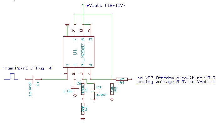

          • SM fig. 4 substitute solved
            Originally posted by bussi04 View Post
            @all
            I have found LM 2907 http://www.national.com/ds/LM/LM2907.pdf
            Appended you find the LM2907 frequency to voltage converter fitting our needs. these parameter values are sufficient for the frequency range 0 to 6000 rpm.
            As usual rename extension pdf to zip to access the KiCad archive file.
            Enjoy!
            greetings,
            bussi04
            bussi04@hotmail.com
            • Hi Bussi,
              Once I get everything up and running again I too will give that circuit a try for I think it will do fine for our needs. Oh, my red line is 7400 rpm, LOL. I need to look up the engine management systems both cars employ to see which car is the easiest to convert, for now only have enough stuff to convert one car at this time.
