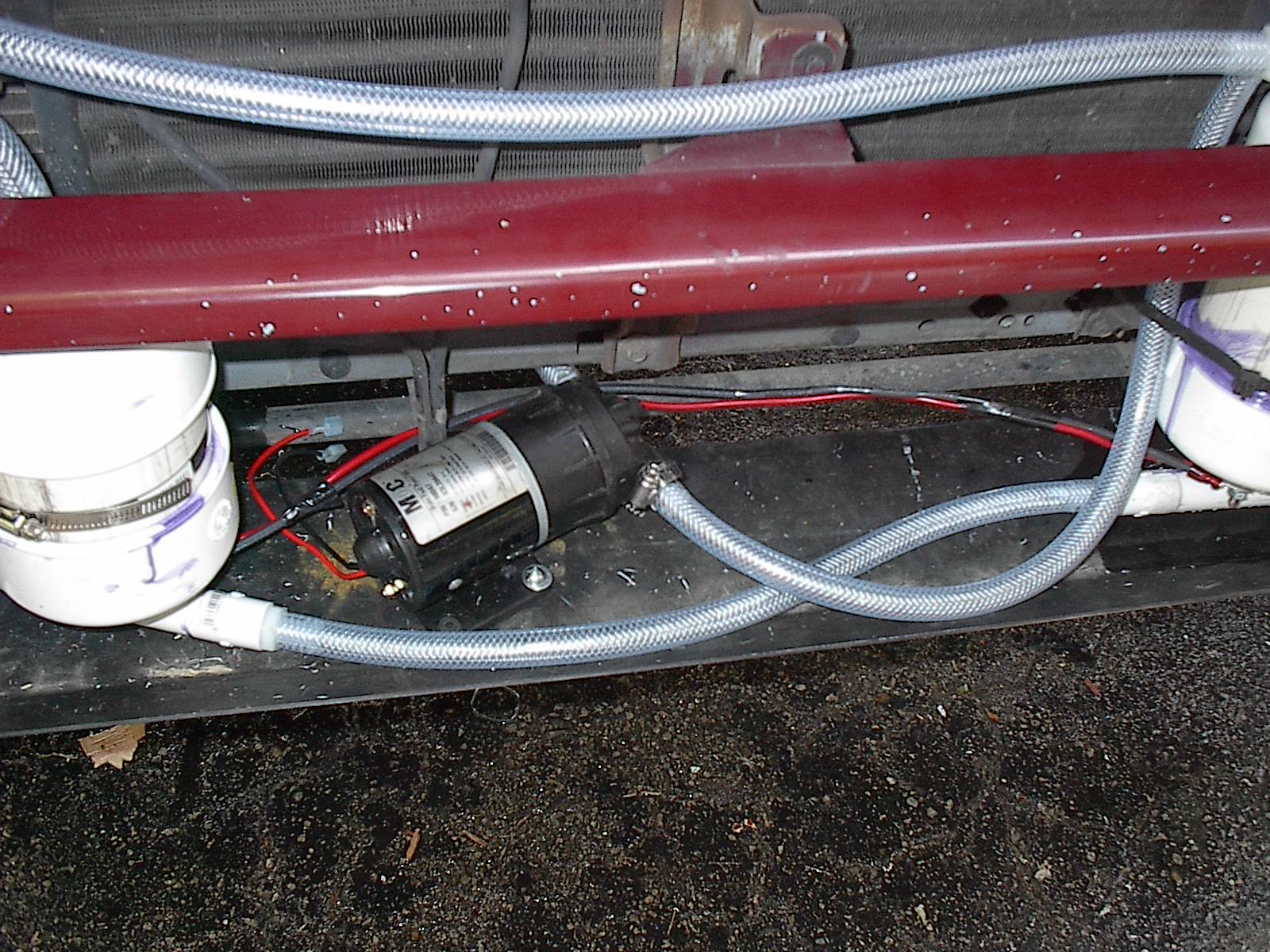

Your on to a good line of thinking, I've been using pumps circulating the electrolyte in my 3rd and 4th generation designs and it doe's increase gas production significantly. attached pics of 3rd Gen on Ford 3/4 ton.
Pump feeds header tank, header tank feeds reaction chambers, Gas and electrolyte feed back to a separation chamber, gas goes to bubbler and engine, electrolyte goes back to header tank.
The pump pictured is a little over kill at 2.5 Gal a min. and 7amps

Tarkus,Originally posted by Tarkus View PostYour on to a good line of thinking, I've been using pumps circulating the electrolyte in my 3rd and 4th generation designs and it doe's increase gas production significantly. attached pics of 3rd Gen on Ford 3/4 ton.
Not intending to deviate from this post but your pic posted is fascinating.
Questions
-Is that a dual booster with a combined circulating electrolyte system?
-Did you mount them out board due to space constraints.
-Does the bumper go back on in front of your set up or do you leave it open?
Thanks for sharing

The space in the engine compartment is tight, room on ether side of the radiator for separation chamber and header tank, duel reaction chambers and pump sit behind bumper, electrolyte circulates through tubing in air stream to assist in cooling.
Gen 4 system: has 4 individual reaction chambers, integrated pump, Hydrogen/Oxygen separation cells, electrolyte cooling radiator. Reaction chambers are smaller with higher gas generation. Will share design as soon as testing is done.
Yes going in to commercial production is a possibility.
Gen 4 Tarkus

Thanks for that. Any issues with pump seal breakdowns with the caustic nature of the catalyst?
Could you post another angle of the set up I only saw two boosters. Think you mentioned 4?
Very Nice by the way. You should consider going commercial!

Tarkus,Originally posted by Tarkus View PostWpage: Yes, Yes and Yes.
What size are your canisters (L and Dia.)? and what do you mean individual reaction chambers? Is it bsaically 2 cells operating in 1 canister? I was thinking of the same approach for my Chevy Express Van (7.4L engine) but need some help in designing. Currently I am using 2 cells in series, each brick is +nn-nn+, 2 volts across each plate. I know I am probably going to need more cells for such a large engine. We need the van, hence my username. Any input would appreciated.
Thanks, Chuck
