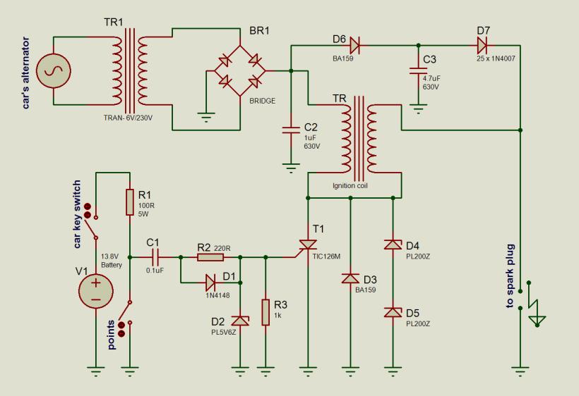

    To help solve the charge pump issue, I thougt this idea it's a little bit better than the inverter.
    Inverters work at 50-60Hz (sine signal). After passing the bridge rectifier, the frecquency becomes 100-120Hz.
    Now, why use (and sometimes burn... ) inverters to charge capacitors when your car allready has a better oscilator device as standard?! I was talking about the CAR'S ALTERNATOR.
    It makes the electrical energy for the car. The current is AC type and has hundred of Hz at idle. As the engine's rpm rises, the frecquwncy rises also. Adding a bridge rectifier, it doubles the frecquency!
    So, that is what I suggest:
    alternator -> usual 7.5V/230V transformer -> bridge rectifier -> capacitor.
    Yes, it's not as good as a DC-DC converter that works at much higher frecquency, but it's better than inverters. And yes, the bigger the transformer, the quicker the capacitor is charged.
    Look at the schematic attached.
    All the best for all.

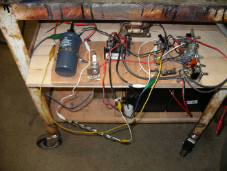

            Hi DonL
            I used some copper coated welding rods as the coil core. I took three wires, each about 50 meters long, then I twisted them together so that they form one thicker wire (Litz wire) and then I just wound that big wire on the coil core. The coil has about 400-450 windings. All three wires are AWG 21. But there is no need to twist the wires, there is no need for copper coated welding rods - any bolt will do fine. Also the wire gauge is not that important, you can use anything from 18-25. Just the windings should be at least 400
            Also you don't even need a trifilar coil, you can just as well use a bifilar coil like this:
            (just replace that battery with a cap. I have not tried this by myself)
            Here is a pic of my coil:
            And this is my latest circuit with no booster side attached yet:
            With this setup I can go with the spark discharges as high as 200Hz using 2.2uF 450V electrolytic cap. Then I attached two more caps in series to reduce the capacitance to 0.73uF and I could go as high as 350Hz. At last I replaced the electrolytic caps with two 1000V 0.88uF polypropylene pulse caps in series. Now I can go up to 550Hz with no problems. I guess that if I decreased the capacitance more, I could go even higher, but there is no need for that. Also I think that this could be about the limit that the ignition coil can handle. But the best part is that this whole circuit draws only 100mA from a 12v battery

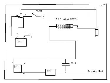

                                Jstadwater
                                Here is the schematic .my capasitor is actually 2 ,a 10 uf start cap and a 15uf start cap it will work with either but is stronger with both , the diodes i tried with one string of 7 it worked but drowned when sprayed with water very easily with 3 strings it is much harder to drown . I used a 555 chip with a rfp50n06 mosfet to pulse the coil 1 hz to 34 hz when doing bench tests .The coil does get a full 12 volts and gets warm . when i hooked it to the points on the motor it ran great for 5 minutes then the electrodes on the plug fused together and lv side shorts out now ?? This motor has external points that run off the cam (no waste spark) .I will try a micro switch instead of points so the coil will fire when the switch opens on the cams down stroke to retard the timing (for hho) and reduce the amount of time the coil gets 12 volts (less heat) . I tried using the magneto but no luck yet with it .
                                Will
