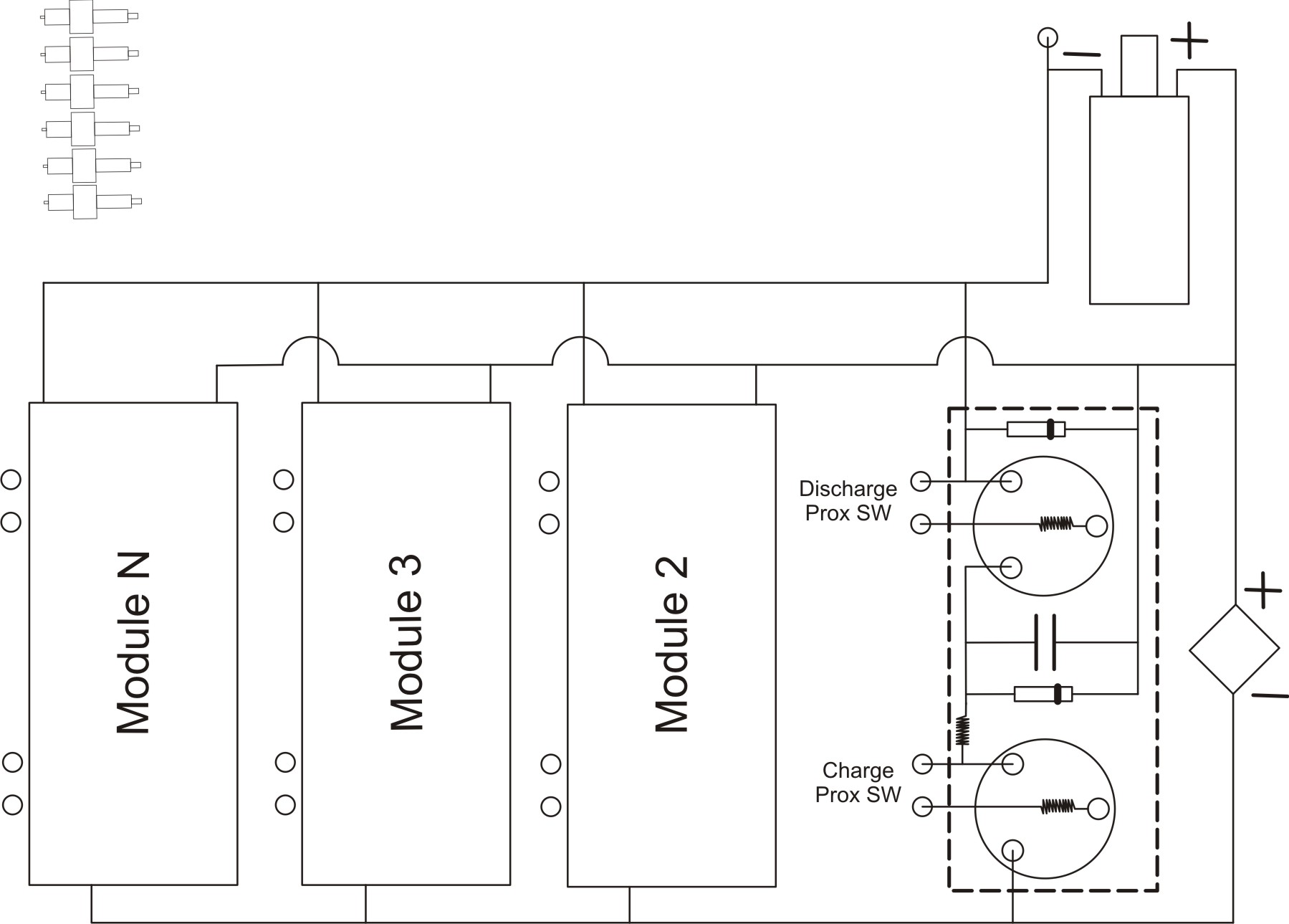

Since you and Jetijs are making such good progress and your GenSet adaptations, I thought I'd watch your updates. I'm not an electronics expert, but am able to follow your schematics. I was waiting to see the final Nexus schematic and start experimenting on V6 GMC. I just recieved all the parts to replicate your solid state schematic. With your latest schematic I'm thinking I'll follow your lead and see if I can contribute with a V6 adaptation.
So here's some questions to ponder:
You're bypassing the points and condenser...?
Assuming one could comfortably operate an ICE under 4500 rpm, then on a V6 you'd need to operate the cap charging at ~ 150Hz, assuming a single cap. Is that possibly ? Or do you need a cap/plug ? With a ring under the rotor, you could always be charging 5 while discharging 1. So you could charge with 300 deg or rotation and only discharge with 60. The reed switches could be mounted around the distributor thus allowing for easy timing adjustments.
Just some thoughts. I'll gladly go to building if you could help with the schematic. Then I can contribute to this group.
Timm

, adding Gregs tonight, we have a new circuit just need to draw up, did some filming over the weekend, and will try the spark with a hydroxy booster on our genset this weekend, video coming.
