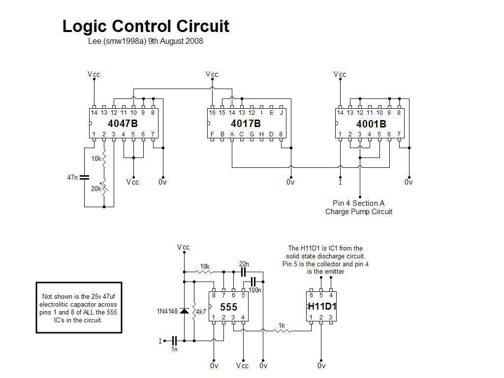

                • Logic Circuit
                  Hello All,
                  Sorry for the delay but life kind of got in the way, as it does. This circuit took much longer than I thought. I felt I had to redo it twice before posting because it looked far more complicated than it is. This is the fourth and final part of the circuit. The four schematics represent the actual circuit I ran in the Water Sparkplug III

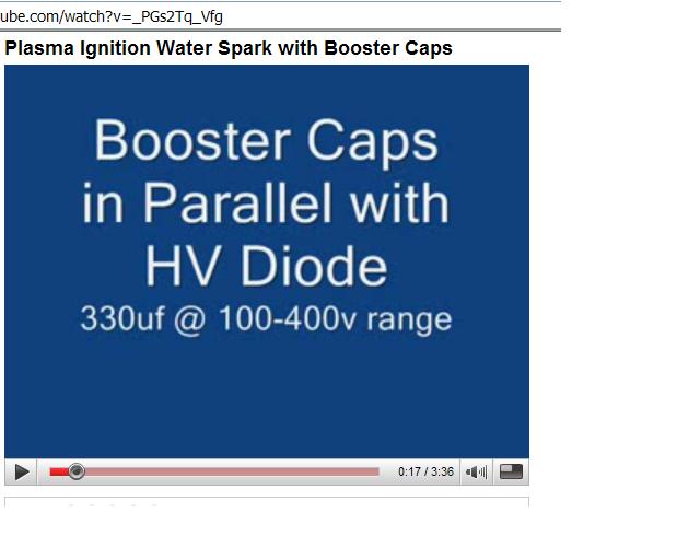

                  • booster caps
                    Hi Bruce and Magneto,
                    The video says booster caps in parallel with diode....that might be confusing...it is booster caps with a diode in parallel with plug.
                    I already posted my booster cap schematic here and it is identical to that.
                    Just that I'm using a string of 15 diodes (1000v/6a).
                    Look at Luc's schematic...he has the inverter through bridge in parallel with plug...simply put caps across the plug in addition to the power source.
                    I'll post another schematic or something later.

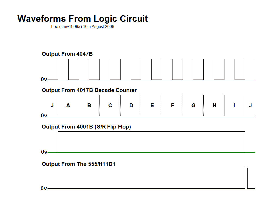

                          • Ligic Circuit Description
                            Hi Guys,
                            I have attached a representation of the waveforms from various parts of the logic circuit. I hope it helps.
                            Regards Lee...
                            • Thank Lee. It's useful information for me to make a microcontroller program. I complete my board now and will make a spark in next day
