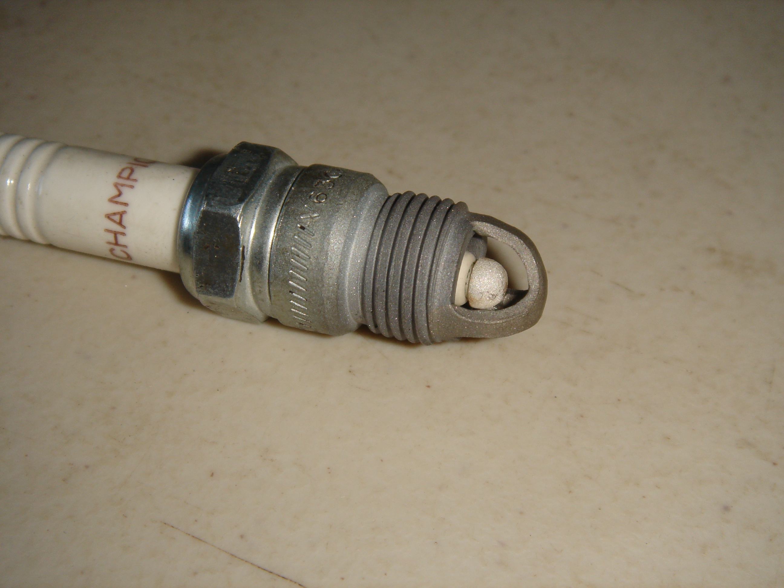

Like this?

These are the critters I'll be using.

Already done it. Doesn't produce anything amazing. 10 Psi increases per pulse, but not enough to make an engine run on steam. Also Firestorm does not appear to do anything more than a champion plug with resistor and J-electrode removed. These results came from the Firestorm team backed by investment money, Orem, Utah. To see maximum effect take a champion plug, remove the resistor and J-electrode, then fire it in open air and compression test chamber. Put the Firestorm plug next to it and you will see more plasma created by the champion (larger area). Kiker wire also helps, but not to an extreme.Originally posted by gmeast View PostHi rosco1,

Later engine run tests showed the same results. Inexpensive Champion plug with modifications runs an engine as well if not better than the Firestorm. Mileage and exhaust gas analysis showed they are almost identical with the Champion performing slightly better and only the power level provided to the plugs makes any difference. Tests at Nology labs showed the similar results to ours. Small increase in mileage, moderate reduction in emissions.
