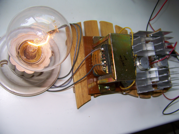

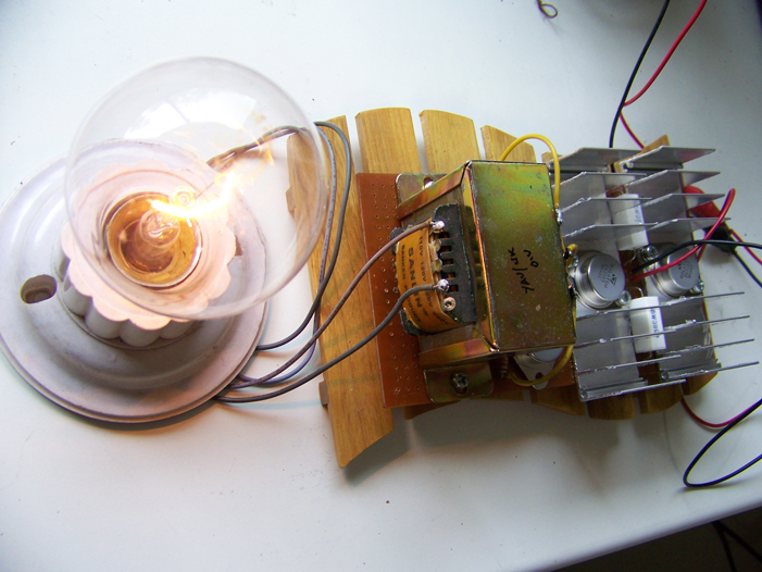

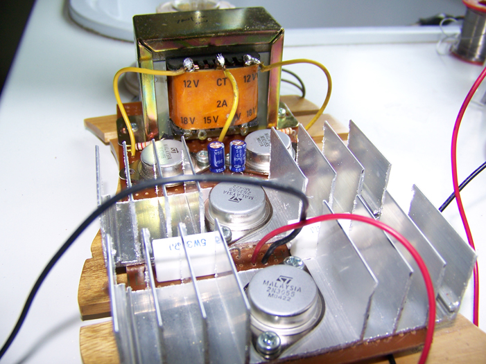

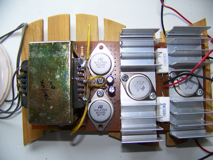

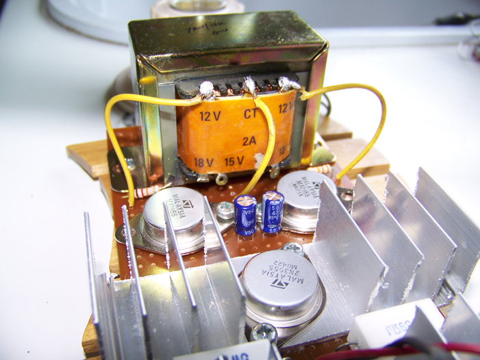

Hi Everyone,
I made an inverter oscilator based just like what Greg's done before. I used 39 Ohm 5 watt base resistor and 2 A transformator to light 25 watt bulb. It worked well so far, even the transformer get little hot and the 2n3055 transistors get warm. It seems enough to drive plasma booster ignition setup with 9-12 uF cap. I hope this works on my motorbike.
Here are some pictures of my oscilator setup.
PS: Thanks Greg and others who provoked us to built it to prevent inverters fired.
Revizal.
