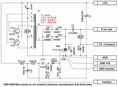

Below is a pic of the board, awaiting the transformer, and the heat sinks are not on the transistors yet. I am also going to use computer fans in both ends of the project box to make it a wind tunnel.
Here is the schematic. If you look at circuit you’ll see auto generator with secondary voltage about 400V then bridge rectifier and than T112-16-10 and then after C2 is output to ignition coil. Only difference is- this 400V impulse is going in to the primary of ignition coil. Dear friends! Please make Your MPG tests! If there is NO GAIN, then your job goes to nonsense.
