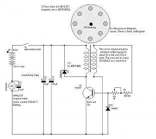

                            OK, now i've got the whole thing. I've made my coil, with two wires, and i built a self runner, with one single battery and a cap. I tried with iron nails as core for my coil, but the magnets were attracted by the nails. So i removed the nails, and it's a air core coil now. I put all in place, spinned the rotor and get nothing except a strange sound like in this video :
                            Bedini monopole motor sound 1 - YouTube
                            The coil generates a north as it pushes the magnets that are north oriented. But i get no accelaration, the coil vibrates as the rotor spins, the coil is not hard fixed to the ground, should it be ?
                            What is this sound ? How to debug ?
                            Thanks for any help ...
                            Eric
                            The shematic is this one, with a 2N3055 and 470 R + 500 R pot.

                            • #15
                              sounds to me like your coil is self oscillating, which would indicate the resistance is too high.
                              try using a 100Ω resistor and the same pot, and see if that doesn't solve the problem.
                              You can also try taking some turns off the coil, since it will have it's own base resistance, and if that is too high, you get no spin either.
                              hope that helps
                              N8
