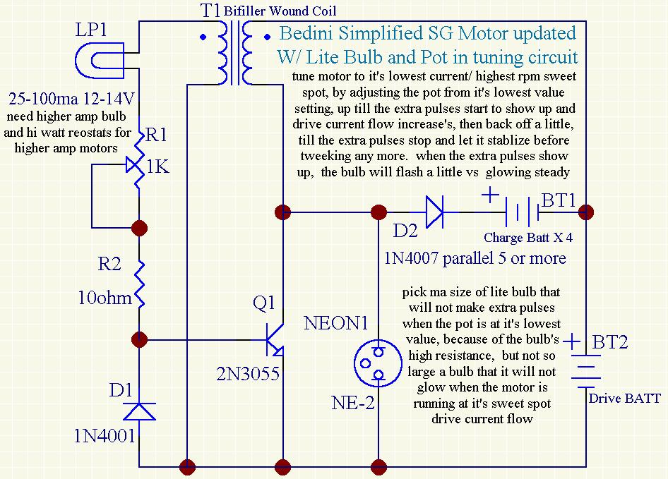

          My situation with the lamp in the trigger wire is as follow: I have a 50mA and a 100mA bulb. Both are brightest when poti is in lowest position. Then they dim if i turn the poti while ampere draw gets smaller.
          There is no 'light up a bit', there is only the transition from light to no light. Not going philosophical now...
          Same characteristic if i change the 100 ohm to a smaller one, only the light is brighter.
          So how can the light help me to find a 'spot'?
          I can measure the ampere draw, it's between 200 and 500 mA.

            Bedini schematic
            Today i installed a rpm sensor. Right now the rotor spins 800 rpm.
            With the 6 magnets i get a frequenzy of 80 Hz i calculated.
            The rotor has 17,5 cm diameter (about 7").
            2nd: I would like to see the pulses per magnet pass with that LED connected to trigger. If you understand what i mean. I saw that on some videos. I have no oszi and this would be an idea to verify the operation of my machine?
            Thank you!
            Shin
            See bedini schematic:
