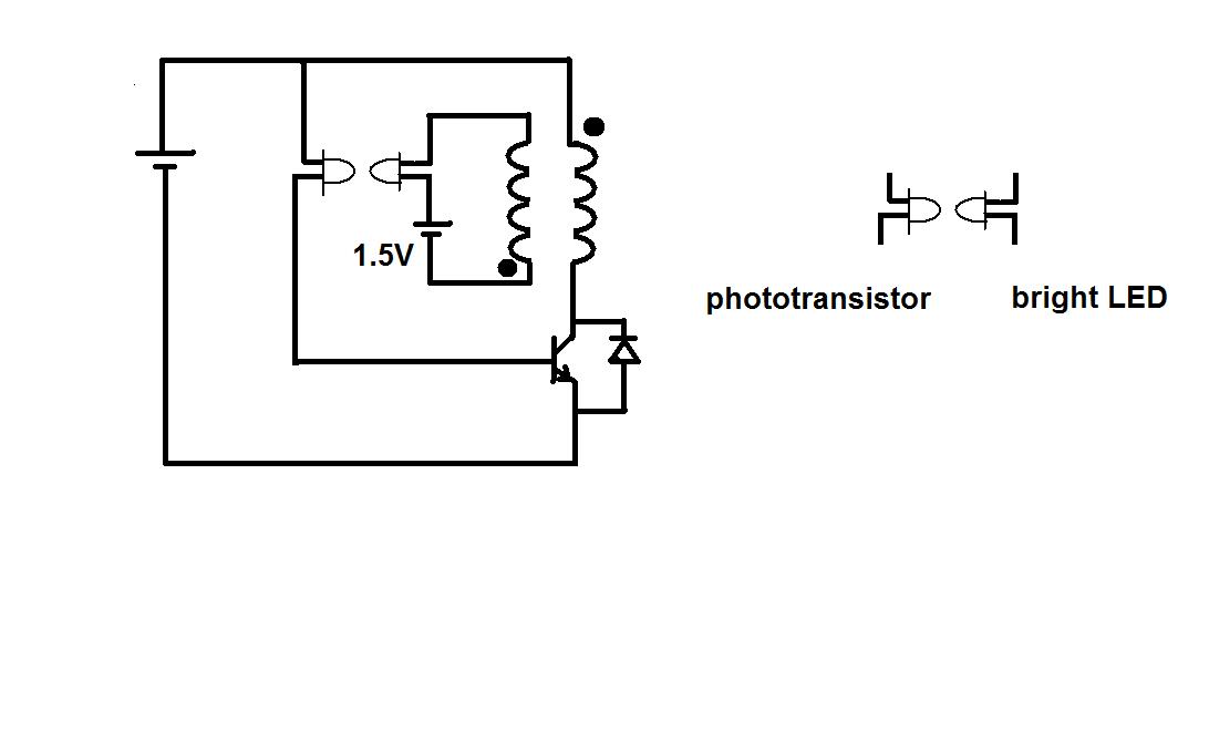

      I think it acts as a dampener to the base diode. I agree that we can save some energy by tanking it with diode. I've developed a new type of triggering using photo-transistor. I used a photo-transistor coupled to a bright LED. The 1.5V is to boost the forward voltage (my rotor is very slow). The LED helps eliminate self resonance problem. The photo-transistor put out around 15-20 mA max and I think it operates up to Mhz range. I'm using it to explore oscillators.

          @quantumppercut -
          That's how the ball type PC mouse encoders work..is that where the idea came from ?
          Some old arcade machines also use that system, the driving ones. When I converted my Pole Position to run both the original boards and an emulator, I used a mouse circuit board to handle the steering wheel position.
          An idea for a thumb sized Bedini type, might be to put say 4 tiny pieces of magnet inside some of the holes of a PC mouse encoder wheel and fit the wheel on ultra slick bearings. Use an SMD transistor and finest grade of magnet wire wound bifilar for the coil(s). Reminds me of a Flea Circus in how it may look !

              Thanks Slider,
              Originally I was trying to aim a pen laser at the photoxistor, but the alignment was too hard so I came up with this way. But darn, it's not original. lol

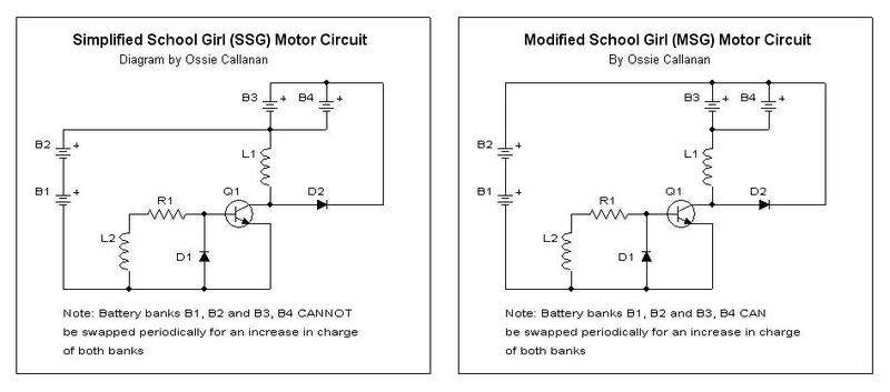

                      When I originally made this modification I was running my ssg in a Tesla type battery configuration as in the second picture attached.
                      Today I connected my batteries in Bedini fashion with 12 volts on the run side and 24 volts on the charge side, I typically run at about 3 to 5 amps input with this set up and get good charging. But with the diode modification I experienced the same thing Zooty had. The coils self oscillated and the wheel would not spin, but I noticed a very fast voltage rise on the charge battery. I have not done any work with solid state but decided to give it a try. I tuned it to 3 and a half amps input and charging seems very good, everything is staying cool so I am going to let it run.
                      Still not sure what is happening with it set up this way but incase there is a benefit I will make some more tests.

                          I am testing this also. So far, what i have found is that the primary is not dropping as fast as it does in the normal configuration and the charge rate is very nice. I put a scope across the run battery and there is definitely some back popping going on because i get spikes appearing. Interesting mod

                              Solid state, can't get it to spin with the diode mod. I am using the circuit in the first post.
