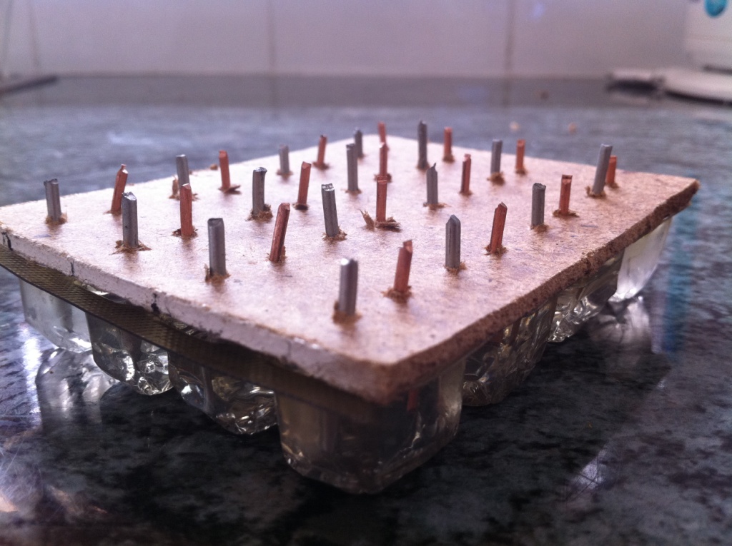

                      • Jelly battery update
                        @all
                        I manage to made worm tray battery from jelly mixture that Lidmotor used. I used an old tray from worm food for fishes and I filled that with alum jelly. I used copper and zinc wire. Every cell has between 0.6-0.9V and when connected in series it shows around 10V. This little tray has 16 cells. When I put load on the battery (LED) the voltage dropped rapidly and LED was barely lighting. When I disconnect the LED the voltage went back to original. I was just wondering if amount of material and jelly had impact on the current and voltage. I thing voltage is not changed at all with amount.
                        @Lidmotor
                        I know that you mention that but I would like to know how to find if this jelly battery is galvanic or not.
                        Thanks,
                        David

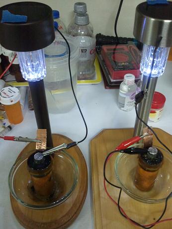

                              • Aged "Gelatine Battery"---still working
                                @All
                                Sorry that I have not responded quickly to the questions but I wanted to wait a little while and do some more testing before I said anything else. This gelatine (or "gelatin") idea worked for me and I hope that someone else can replicate it. I believe that it is just a simple galvanic cell but it does have some desirable characteristics. There is one characteristic that is puzzling though. Gas bubbles form on BOTH electrodes as the cell discharges. Someone here can probably tells us the chemical reaction going on. It looks like electrolysis but backwards?
                                I also did some more research into this type gelatin and found out that when they make ballistic gelatin they add a drop or two of cinnamon oil to the mix to help clarify it and stop the mold.
                                Here is an update video of the "aged" cell and what it can do:
                                YouTube - Aged Gelatine Battery ---still working.ASF
                                Diveflyfish on Youtube has been in contact with me and is doing work with sodium polyacrylate as a substitute for the food grade gelatine. That substance is what is used in diapers to absorb water and he has a video out of his cell made using that.
                                YouTube - Gel Battery NA+Polyacrylate.mov
                                Cheers,
                                Lidmotor
