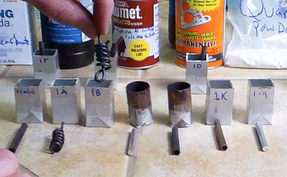

      Here are my results for the first day after cooking:
      Please note these readings where taken at 65F (we keep our home cold)
      Name: outer case / inner electrode / dope / Volts / mA on contact
      1Control: Al / Cu / none / 1.3v / 1mA
      1A: Al / Cu #10 wire coiled / none / 1.4v / 2mA
      1B: Al / Cu #10 wire coiled and looped though bottom of coil then out of top / none / 1.45v / 4.2mA
      1C: Cu / Al / none / 1.35v / .7mA
      1D: Al / Cu / Block Seal (Sodium Silicate)(no water) / .37v / 0mA
      1E: Al / Cu / Crushed Alum (ammonium alum) 1.42v / 2.8mA
      1F: Al / Cu / Hydrogen Peroxide (no water) 1.46v / 5.5mA
      1G: Al / Cu / Crushed Epson Salt (magnesium and magnesium sulfate) / 1.31v / 1.3 mA
      1H: Al / Cu / Baking Soda (Sodium Bicarbonate) / 1.39v / 7.2mA
      1I: Al / Cu / Baking Powder (Sodium Aluminum Sulfate(soda alum) and calcium sulfate) / 1.42v / 26mA
      1J: Al / Cu / Crushed Quartz rocks (from home depot) / 1.45v / 2mA
      1K: Al / Cu Ammonia fumed oxide / none / 1.41v / 1.1mA
      1L : Cu / Cu / none / 0v / 0mA
      1M: Al / Al / none / 0v / 0mA
      1N: Al / Cu / Crushed Tums (Calcium Carbonate) / 1.06v / .1mA
      There are two big findings here:
      1. Baking powder works very well for increasing amps.
      2. A coil that is wound so that its wire is threaded through the center of the coil and out of the cell top can increase amps. Comparing it to the control it increased amps by 400%.
      Thanks,
      Ross W

        Plates are on my todo list as soon as I fine tune the household mix. But, looking at this picture, there isn't a ton more surface area for 1B coil than there is for coil for 1A. I'm holding 1B coil with the end of the coil looping into the center of the coil and out. As you can see there's maybe an extra 15-20% more copper than a regular coil but we're getting twice the amps. Induction maybe?
        @Inquorate
        I'll put that mix in round two, plus I want to test borax so we get a baseline for that too.
        Please note the size of these cells are much smaller than a beer/pop can. They are about 1"x1"x2".
        Thanks,
        rw
          Thank you. How about relative distance, is it the same? Maybe the rule is same as electrolysis, more surface, closer distance, better electrolyte increase amp.
          If it is special shape that make the difference, maybe CW and CCW make a difference.
          • @sucahyo
            Not sure what you mean by relative distance, but coil 1A is actually one loop longer than coil 1B, due to the need for the loop on the end of coil 1B. They where wrapped around the same pen and spaced identically between the windings. The only difference was that 1B looped up and straight through the coil. I'd like to make a larger cell that has multiple coils inside themselves and also test winding directions...
            Thanks,
            rw

                Thanks for the explanation . I meant distance between copper and alumunium.
                • Originally posted by sucahyo View Post
                  Yep, same distance. They where rapped around the same pen so they had the same diameter and both where placed in the dead center of the cell.
                  Round 2 I'm going to test borax, TSP - (Trisodium Phosphate) and Soda Ash (sodium carbonate) and also some combo's of the last round. I'm interested to see what hydrogen peroxide will do when mixed with baking powder.
                  The coolest thing about these cells is watching the volts rise back to their starting place after cell use, with nothing connected to them except the volt meter, so cool.
                  rw
